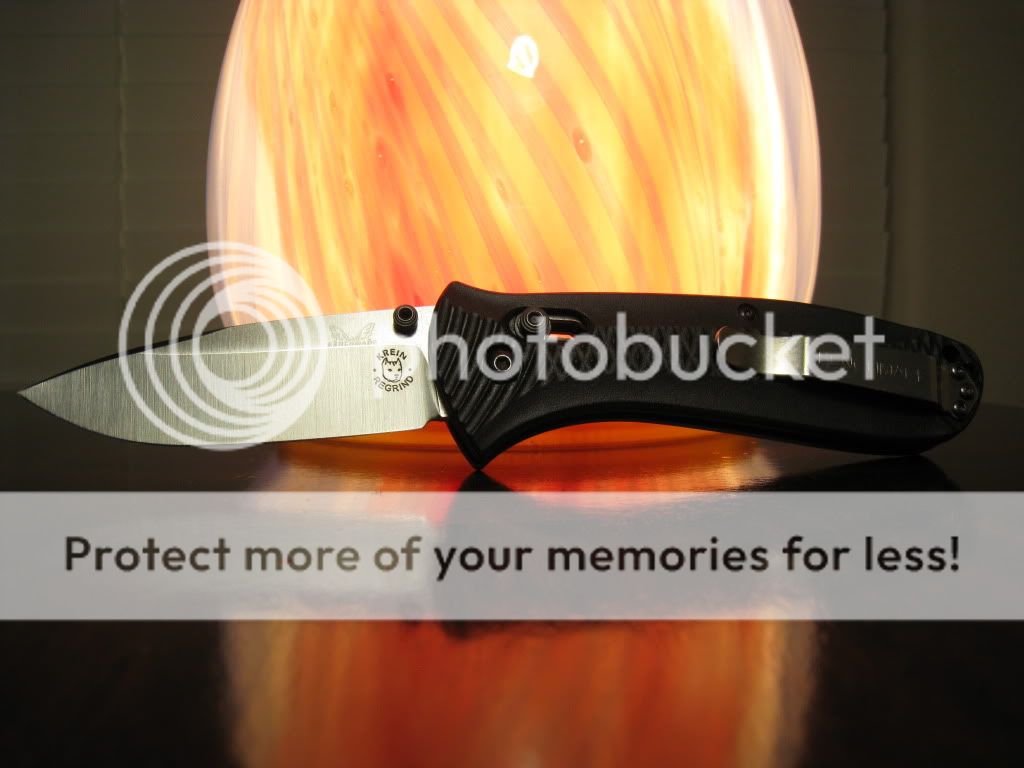

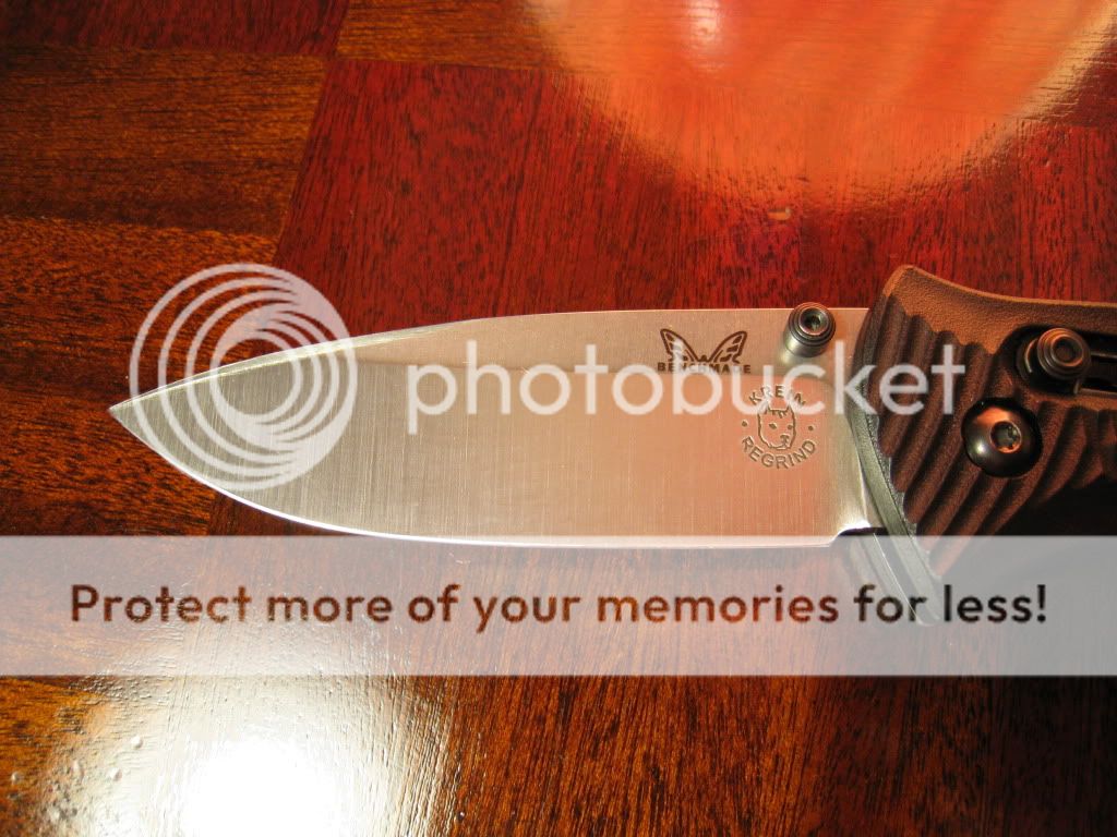

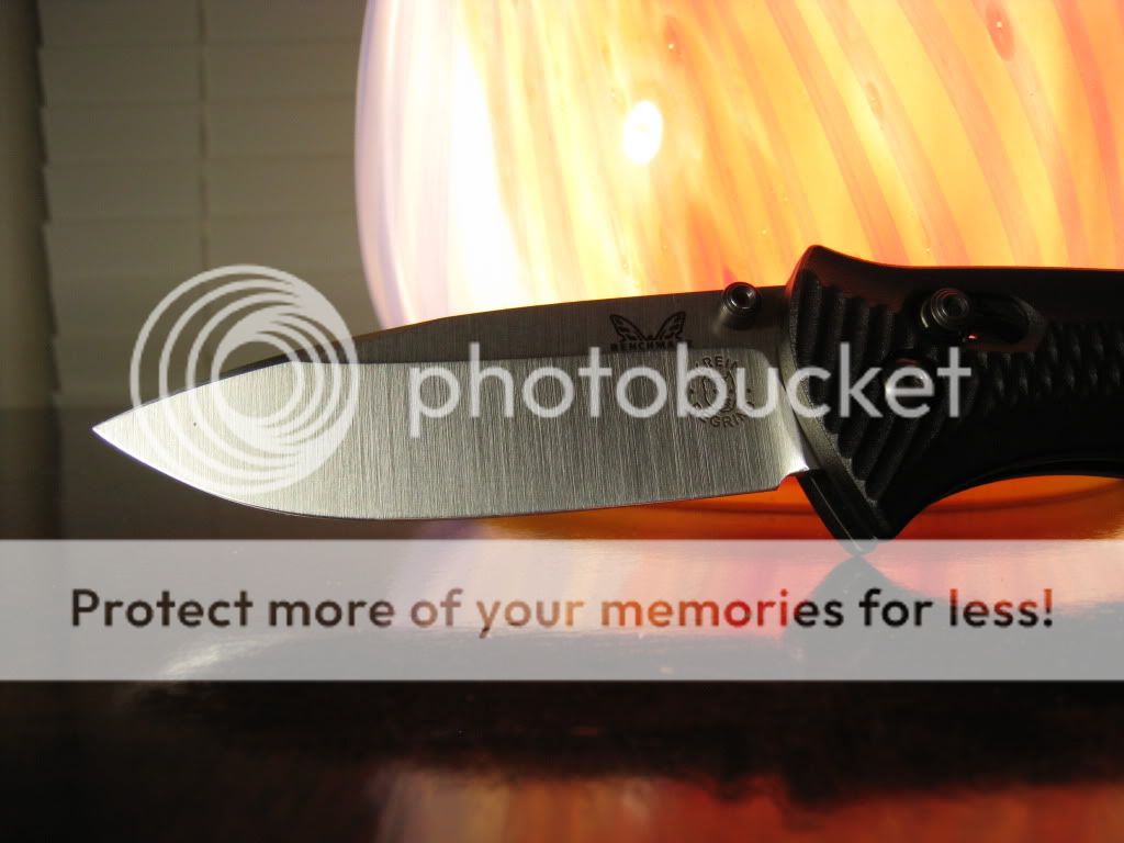

I had my Presidio reground to a .010 edge by Tom Krein and here is the result. Also the hollow grind was brought up about 1/8" higher. The tip is was also ground down a bit to thicken it, as it was feathered very thin from the factory.
A lot of people hate the handle material, but it does fill the hand nicely and has an ergonomic shape. Overall, a good working knife.
My own work was to carefully scrape the black paint off the clip, as it always wears off on the edges anyway.
Starwolf, I'm glad to see that not everyone has gone to bed yet. We need to respresent the territory west of the Rockies:D.
I do like this knife, especially the Axis lock. Bladeplay is non-existant, and it has very smooth deployment.
