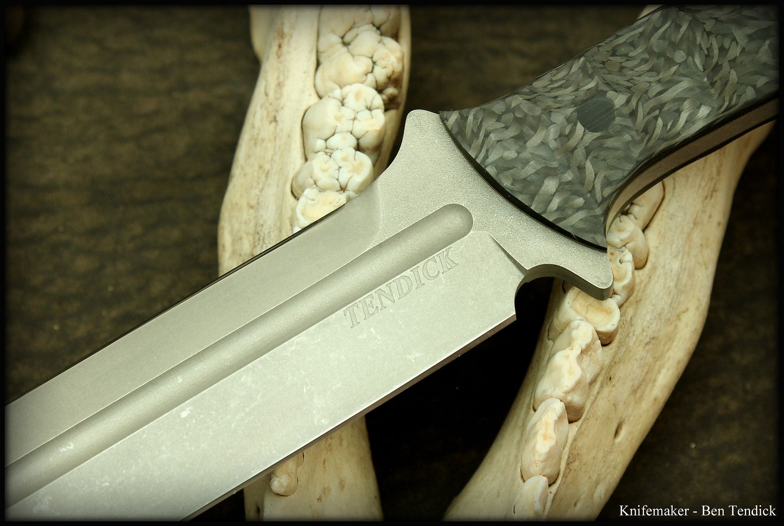

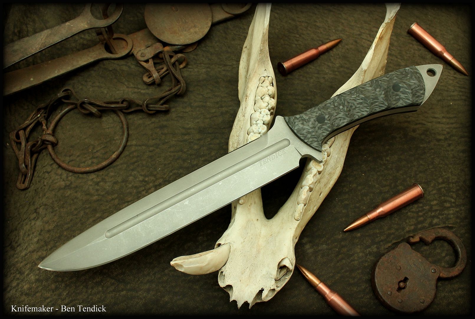

I finished this up a couple weeks ago and it is now in the customers hands. I figured some of you may enjoy seeing it.
This was designed based on his input and features he wanted in a hog hunting knife.

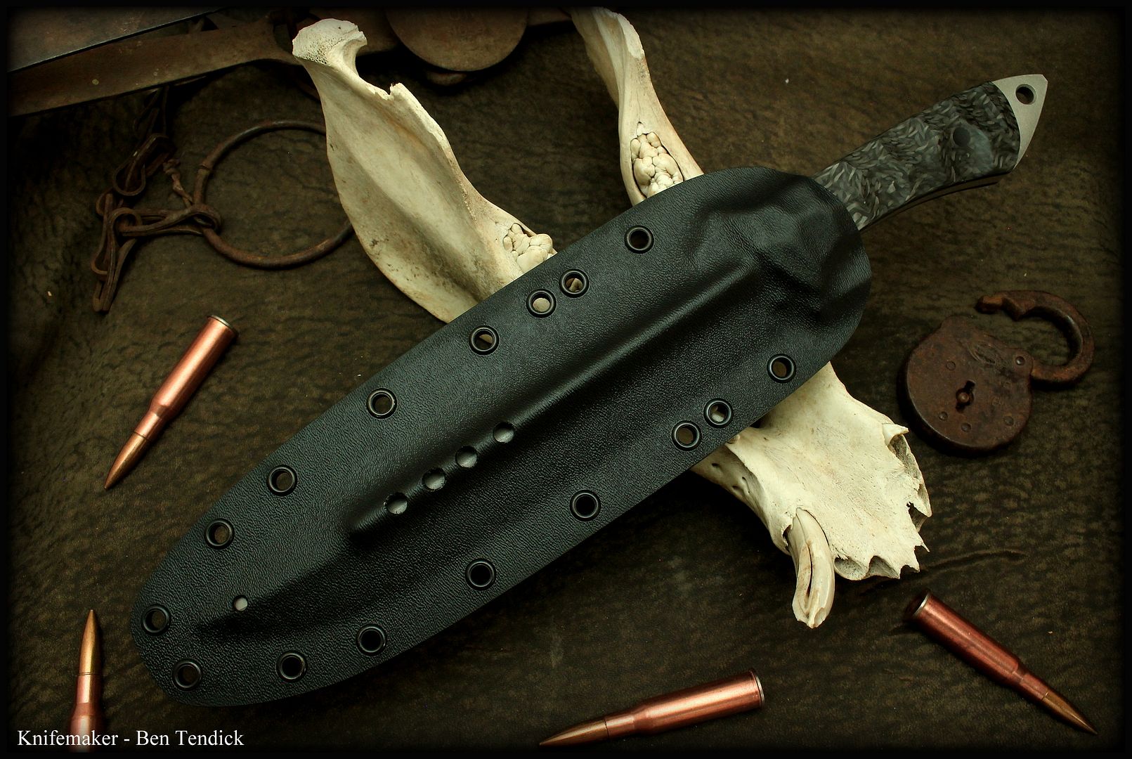

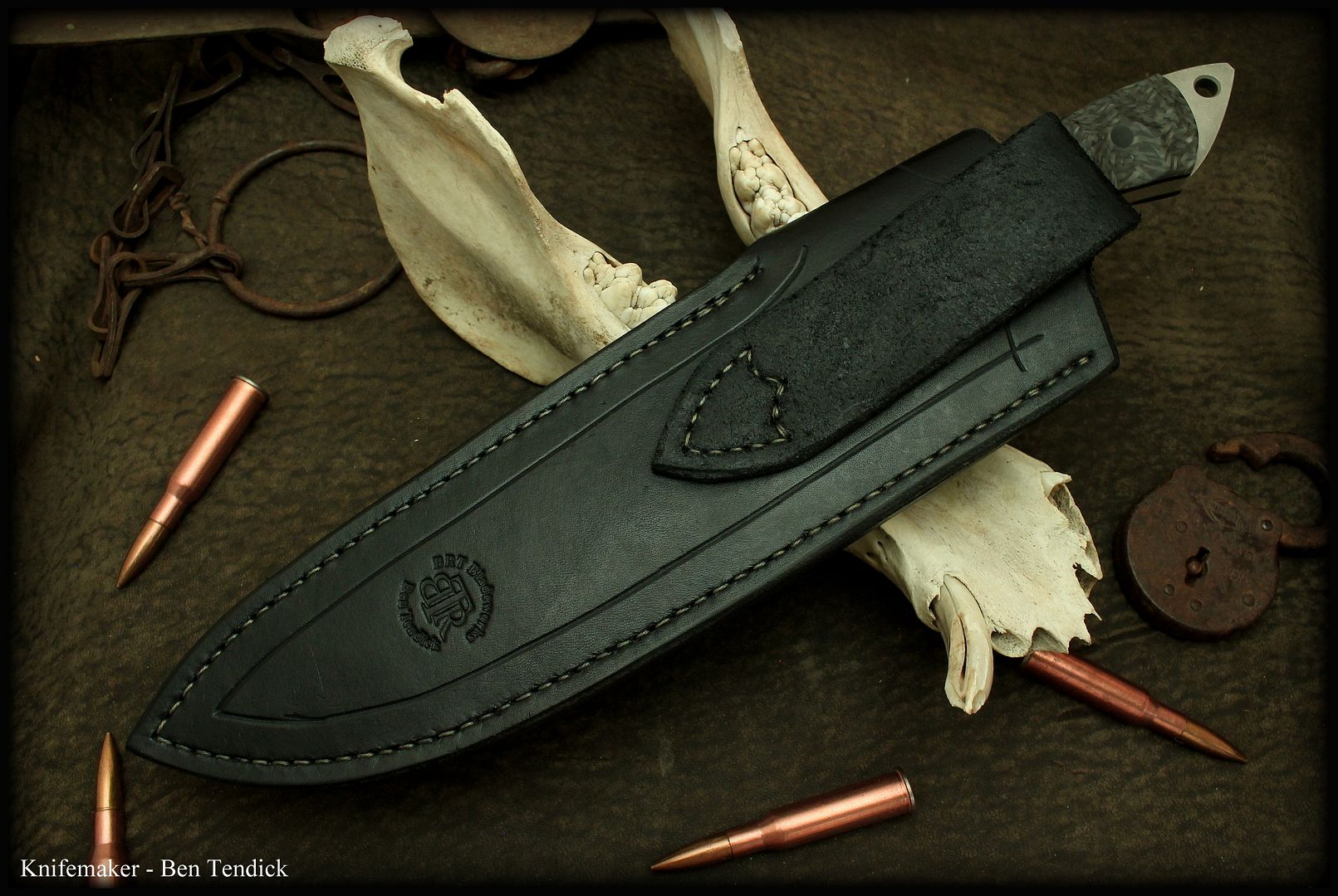

The blade is 8" long and is sharp top and bottom. It has a fuller running the length of the blade which really balances out this large knife and makes it very quick in hand. I made both a leather and kydex sheath for this one.
It has a carbon fiber scales and yellow liners. I am very happy with how it turned out and so was the customer. Hopefully I will have some action shots to share soon.
I hope this isn't a dumb question but what is the raised part on the front side of the sheath for? The part with the 4 holes in it.

If I molded the kydex into the fuller, it would scratch the blade and not work properly. So I molded in the raised areas so you still get the look of the fullers on the sheath. The holes are for looks. :cool:
