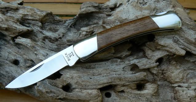

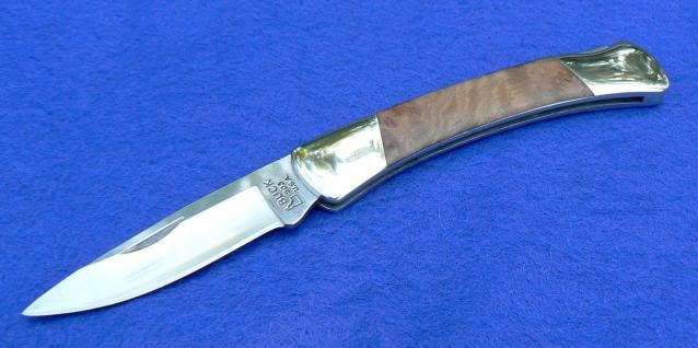

Here's a couple of 503s that I did. First is Black Bean and the second is Coolibah. Remember to block off the holes where the pins were to stop your epoxy/glue from getting into the works - I use tape on the inside of the liners. I also find it easier to attach one scale at a time and let it set up before attaching the second scale.
It helps to roughen up the liners a little with a small sanding block or sanding stick to get better adhesion of the glue.
Thats probably the best bit of advice...plug the rivet holes. It only takes a tiny bit of glue to interfer with the path of the rocker and that could sieze up the action.

BLocking the holes is something I never would have thought of! Thanks a million for that advice! On another note, will the rivets just pull out once I get the scales off or will the push through the other side? How do you get them out?
They pull out easily or you can cut them short and push them through. Either way works.
