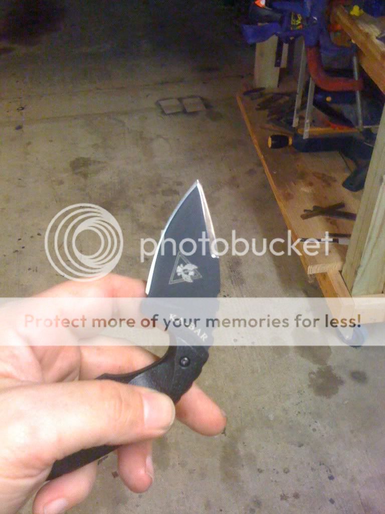

Im a knife nerd, I enjoy making them, modifying them, making sheaths for them etc etc. Well here is a Ka-bar I got to play with recently. Added more thumb jumping and the edge on top.

Yeah this isn't mine but was fun to do none the less. I like more of a straight handle but was suprised that it felt pretty good.
Damn, your pretty good, I didnt even know the jimping was hand done untill Warrior pointed it out :thumbup:.

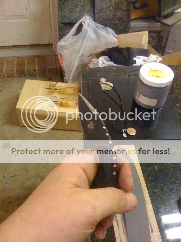

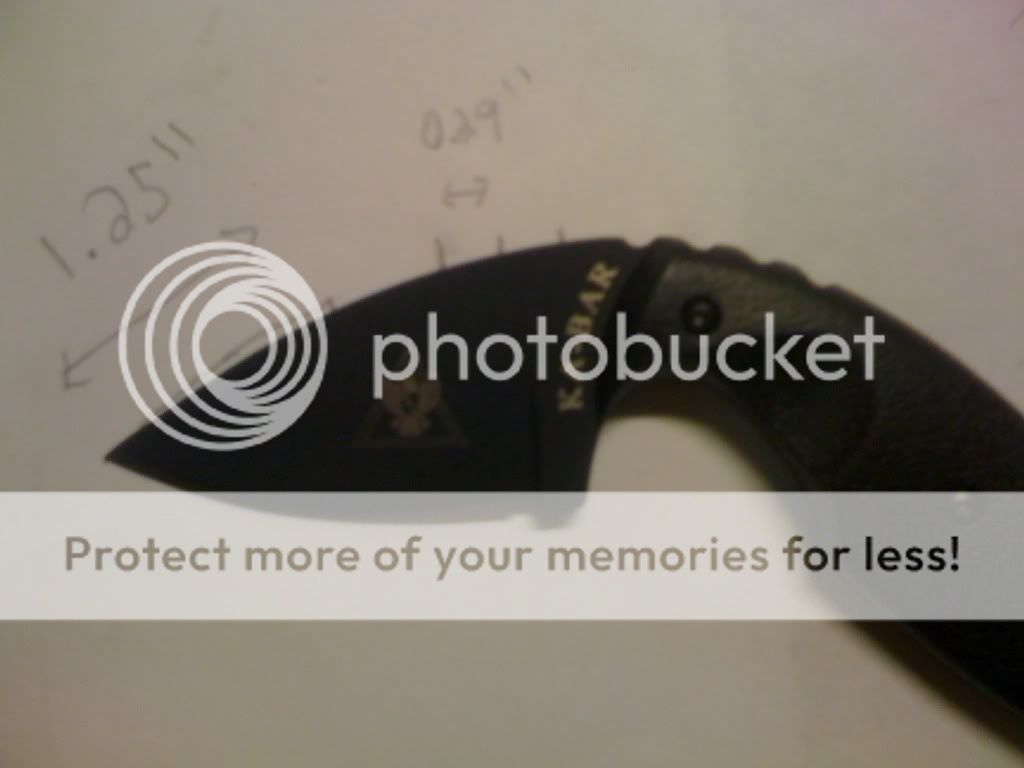

Yeah took measurements with some calipers from the points that were close to each other then the ones that were furthest apart. Most of this job was just making sure they were nice and evenly spaced. After they were filed in I went in with a metal rod and some 220 sandpaper and cleaned them up.
Oh, now that is some good work. Makes that little devil, even better.
