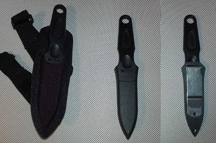

Hi, all. As anyone who bought one of these great little blades will know, the supplied sheath was ruddy awful, BUT with abit of "customizing" you can get a half-decent sheath.
I cut the stitching out with a scalpel blade, peeled off the cordura-type fabric & was left with the hard plastic inner sheath, rub off any excess adhesive & then trim the plastic surround (full of stitch holes!) away from the sheath with your scalpel blade or lino knife. I shortened the height of the sheath-rear & mounted a belt clip that I cannibalized off a rather dodgy tanto-style United Cutlery blade that I had knocking round the house.
Re-shape the rear of the sheath to allow you to grip the handle when drawing the blade & IMHO you get a pretty servicable IWB sheath.
What dya think?
What dya think?
