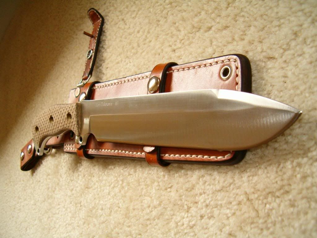

So I tend to prefer spear point in my blades. And I love my NMFBM so much that I decided to give it a spear point. Kept hoping Busse would make a spear point BM but sadly I had to make my own. I know some will like it, some will hate it... But I wanted to share. I love it! I was very careful and kept a pan of ice water to keep the blade nice and cool during the change. Never even got hot to the touch. Took forever that way... but was worth it. I also removed the point at the bottom as I didn't want it wearing a hole in my bag or side. The "Exclamation Mark" shaped ding in the side of the blade was there when the coating was removed. In fact it still has coating in it. Didn't lose but about an inch in length... so it's still regular Battle Mistress length. I Love this knife.

Thanks. It's pretty much the knife I've always wanted... and it's INFI! Can't ask for more. And the thinner edge these had versus other BMs I've owned really makes this an all around great blade. And the rounded spine makes it great at batoning through wood. It's about as close to perfect (For Me) as I've owned.

I traced the curve in the edge so that I would have the same curve in the back... and then spaced it to where they would meet exactly in the middle... marked it with a sharpie and the used this little engraver pen I have to score the line in the steel. Then I used a cut off wheel to remove the excess (that was the hard part because I kept on removing it to dip in water to keep it cool so I'd have to carefully get the wheel back in the groove I was cutting) and my Kalamazoo SM-1 with 100 grit belt to round, shape, and sqaure the spine.
I still have a piece of the tip with about an inch of the edge in tact. It's almost shark tooth shaped. Thought about dressing it up and making like a little hide away knife.

I love it :thumbup: However, I am wondering how much you can actually work with the tip of an NMFBM. So I guess the modification was more for aesthetic reasons, right?

If you choke up on the spine you an use the belly of the tip in either this form or its previous form... the main difference for me is that it's pointer now. It's better at thrusting. Not that I do much thrusting with this blade but in my mind this added a benefit and didn't take away from any other function. And I appreciate it when the tip is in line with the center of the knife. I don't mind such a steep shovel nose shape to it... but one reason I didn't make it a more graceful curve is because I didn't want to regrind the edge. I just brought the spine in to meet the edge that was already there.
