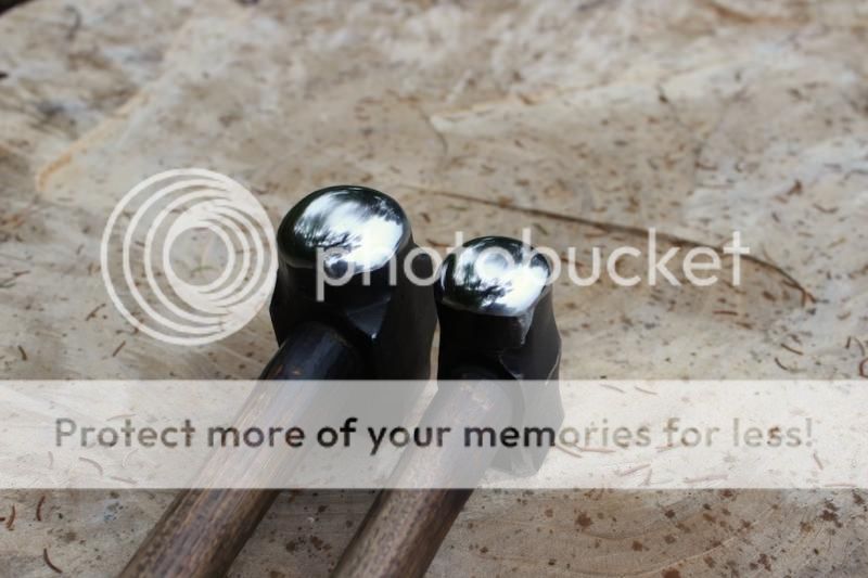

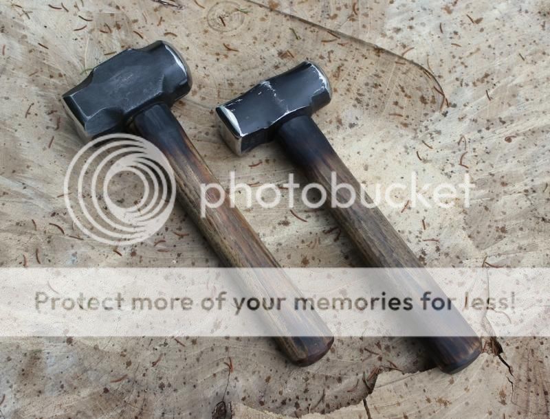

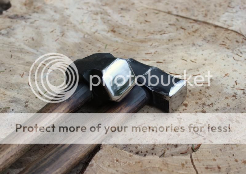

Over the years, my family of hammers has grown in both number and diversity. Most of them have been modified from old sledges and mauls. Here are the two most recent additions. They are basically rounding hammers... one side flat and one side rounded. The flat side has rounded edges to facilitate the Hofi-style hammer technique I use. The round side is not a sphere but rather a squished ball. I swiped the concept from Brian Brazeal. It allows you to tilt the head to achieve various diameter peen sizes. As with the Hofi approach, the length of the handle is around 9-10" under the head. I hold it approximately in the middle and find the shorter handle to work well for me. I had never really considered rounding hammers to be applicable to bladesmithing but I gotta tell ya, these things move metal well... and the control is out the wazoo! There is no "one hammer to rule them all" but these have become my go to swingers. The larger one is 1600g(3.5lbs) and the other is 1000g(2.2lbs).

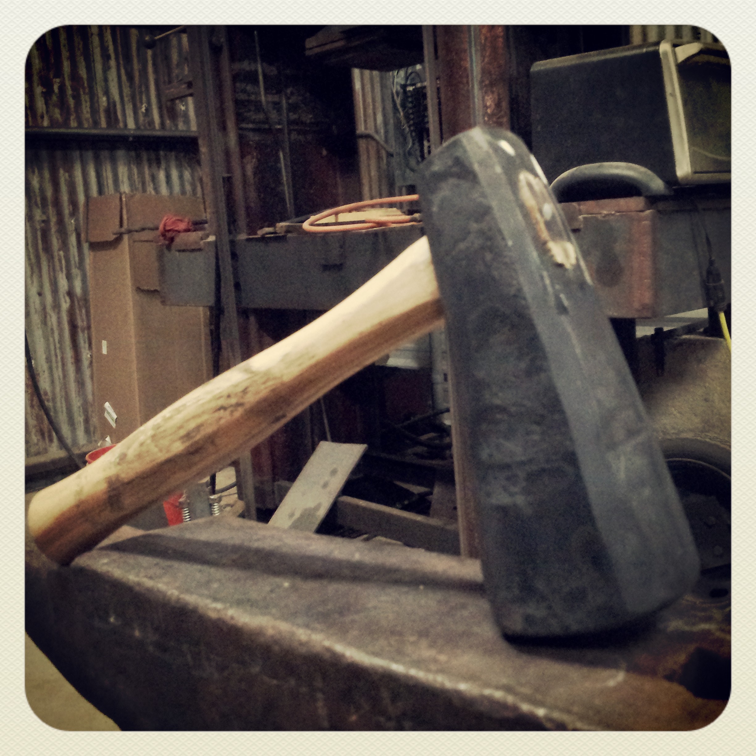

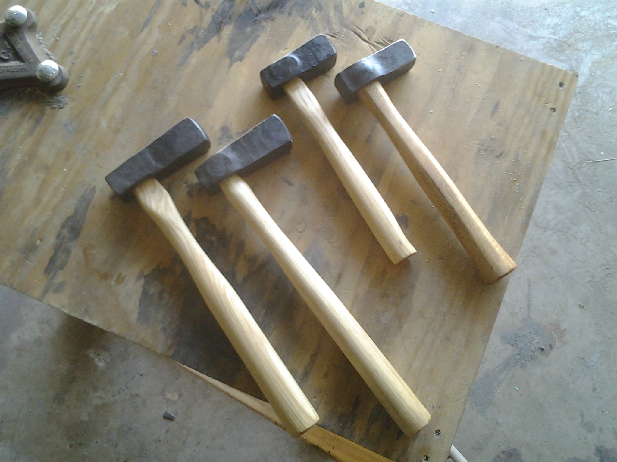

I always wanted to try a sawyers hammer be because i had been a fan of offset japanese hammers. Never able to afford or find one i decided to make one out at storm crows work shop. It was a cut little 2 pounder. After we made that one i found a 3lb atkins sawyer on ebay for 60 bucks, bought and proceed to use those two hammers almost exclusively for 2 yrs. Then may tool bag was stolen from my truck so not only did i lose the hammers i lost my favorite sets of tongs as well. after much crying i got off my duff and decided to make some new hammers.
This i my personal hammer. It's 3 lbs made of 4140 and what i do most of my general forging with.
Then i went a little hammer crazy and decided to make some to trade for cash.
the larger are 2 1/2 lbs and the smaller are 1 1/2 made of 1045.
I know eric fritz has one and so does mardi the other two i cant remember who got those.

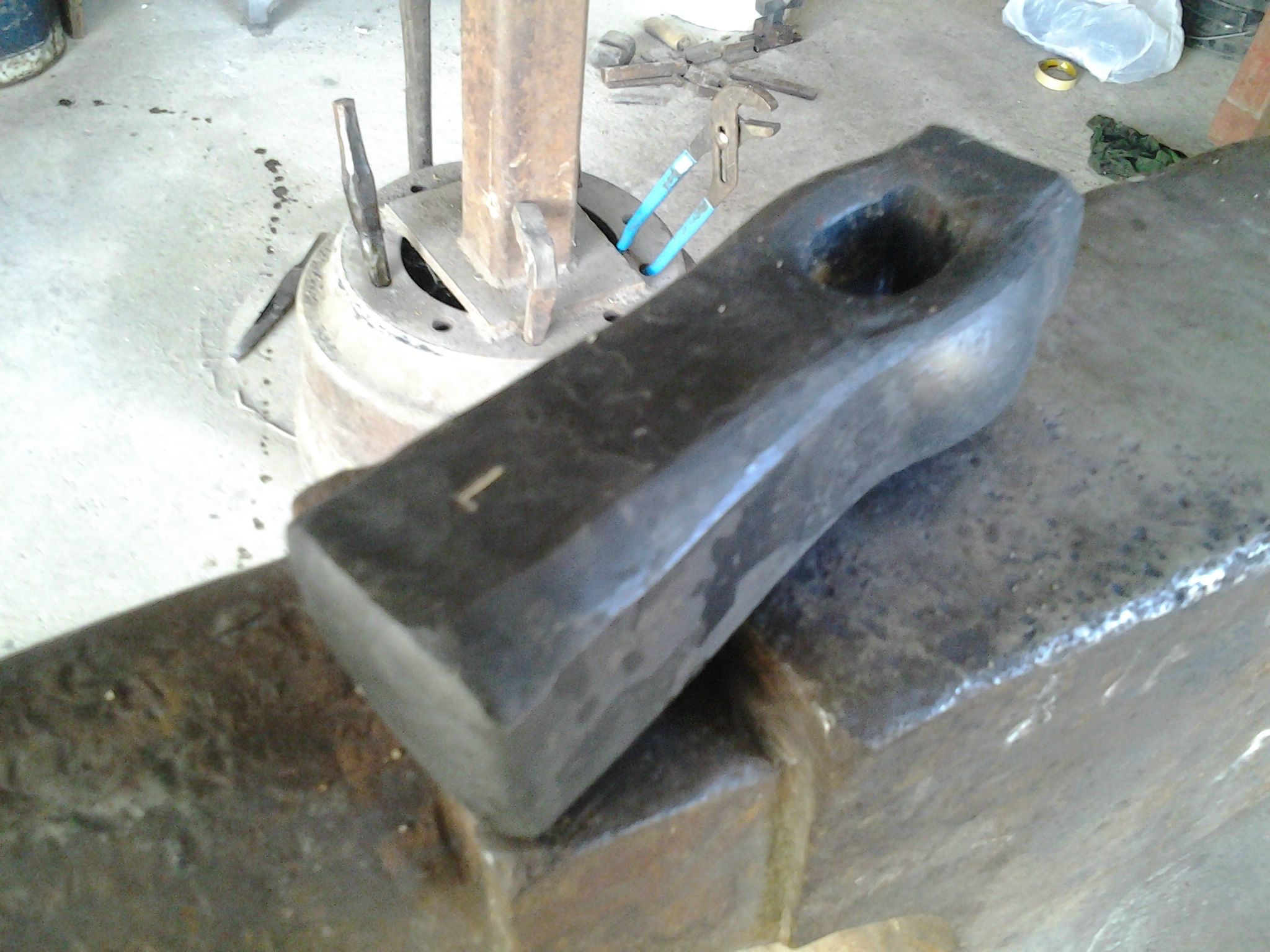

Then i made this one as part of a trade for mardi's large spear.
8lbs of 4140. Hey i only make what the customer wants, but it's a beast. Left it with a flat face and just softened the edges.
I still use the 4lb cross peen i started with for the heavy duty stuff, it has a nice round face. I also use a re-handled 8lb sledge for moving a lot of steel.

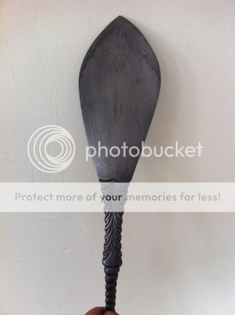

That gigantic sawyer's hammer that now belongs to Mardi Meshejian was a booger deluxe to forge. I had a name for it that is not fit for polite company. It doesn't look as big in that picture as it is in real life. That's a 148 lb. Peter Wright it's sitting on.
Mardi is a hoot to hang out with. He definitely marches to the beat of his own bagpipe. I was the transporter of the spear going from the Denver Custom Knife Show last year to Tobin in San Antonio.
For point of reference, I stand 6' 2". Yes, it is all integral, all patternwelded.
