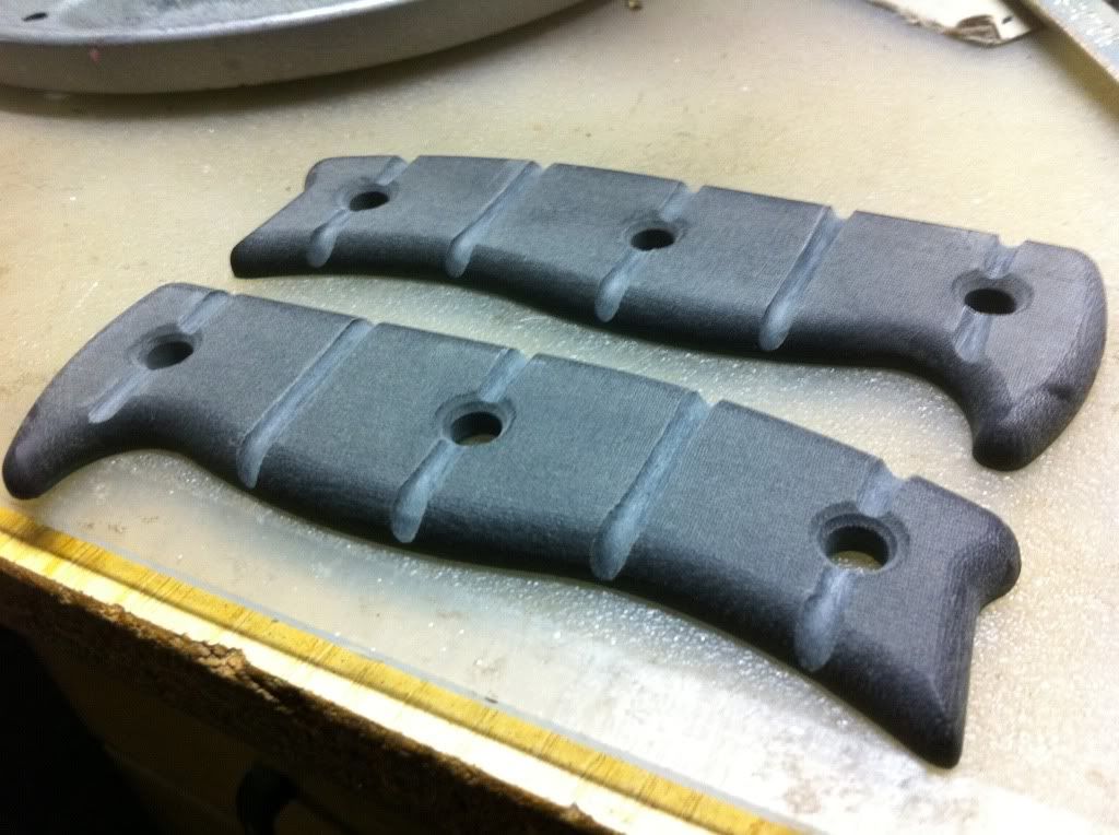

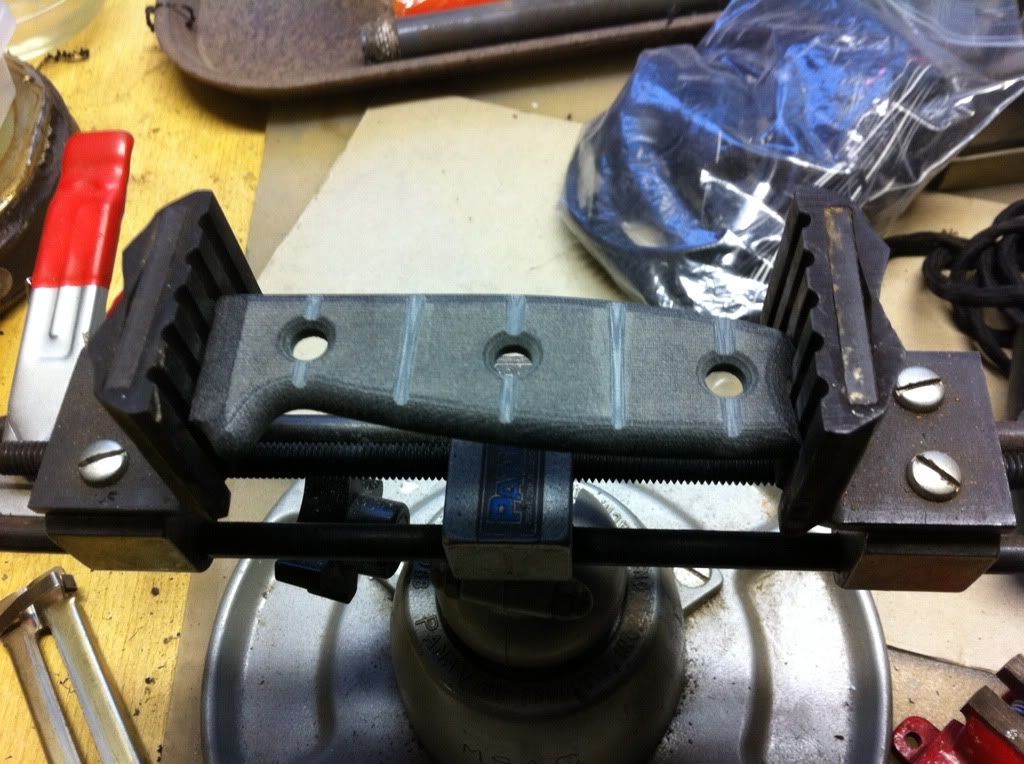

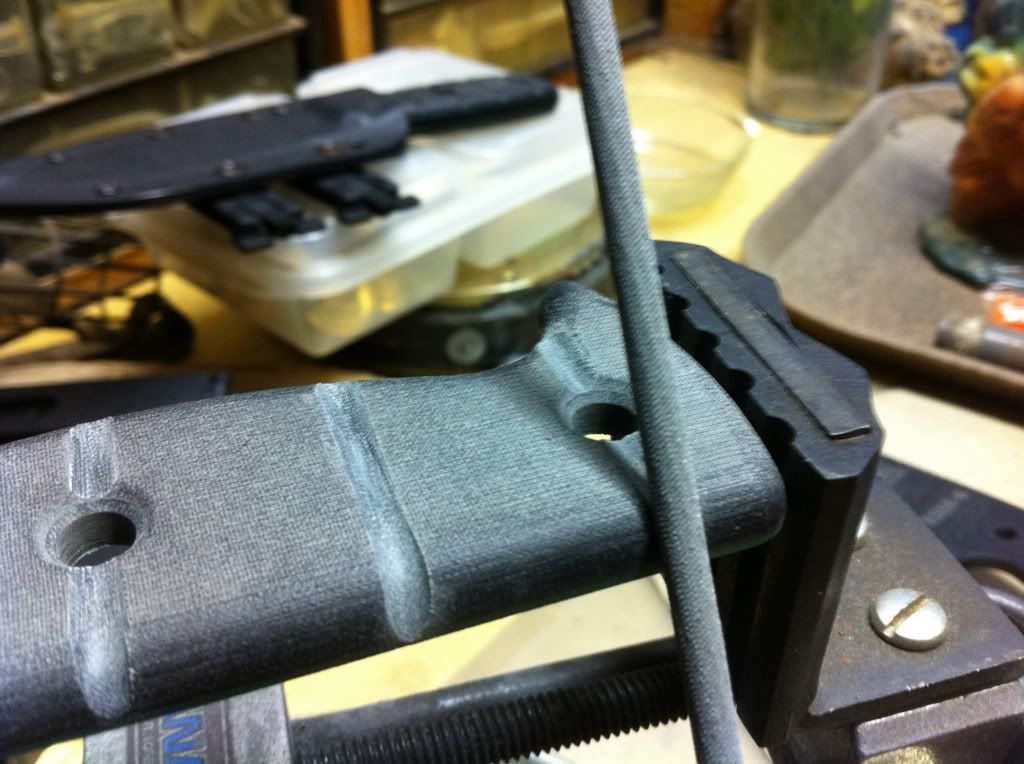

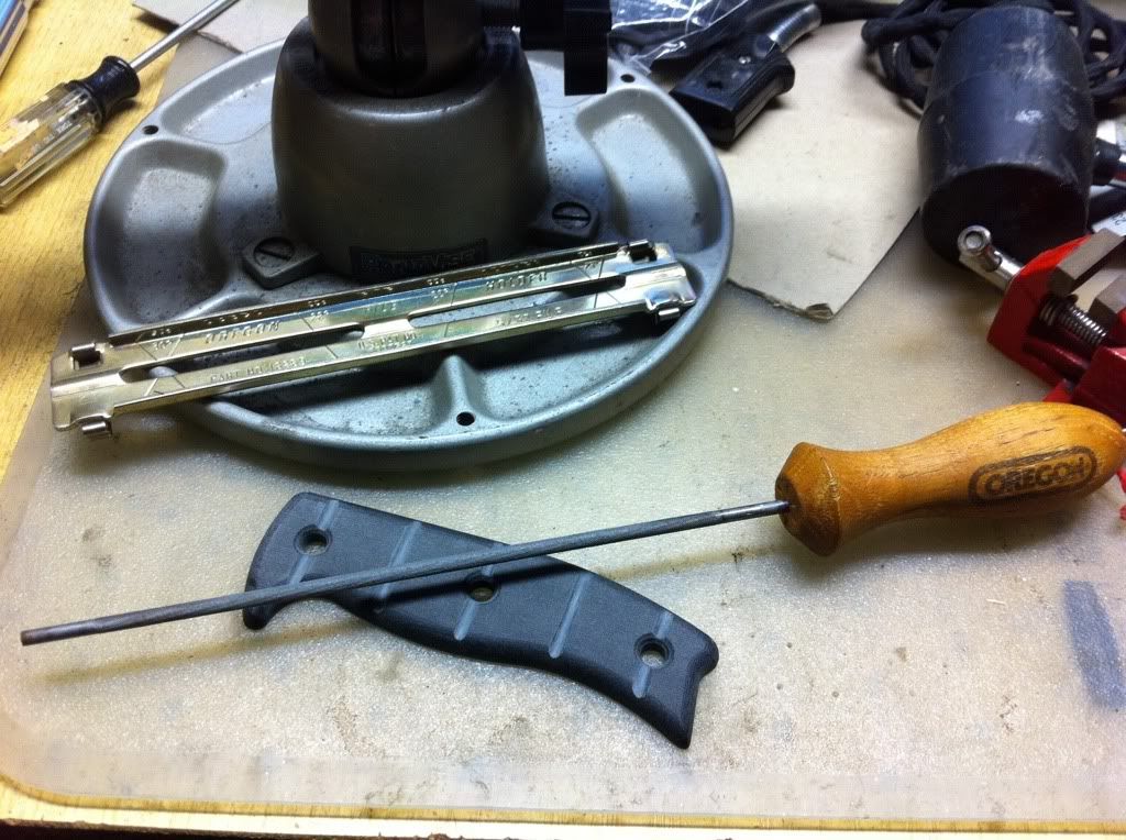

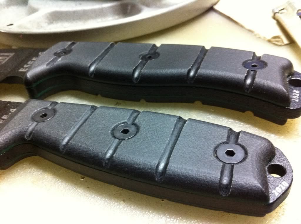

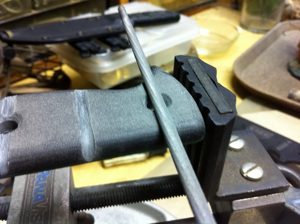

Hey everyone! I got bit by the modification bug... What do you all think? Grip is greatly increased.

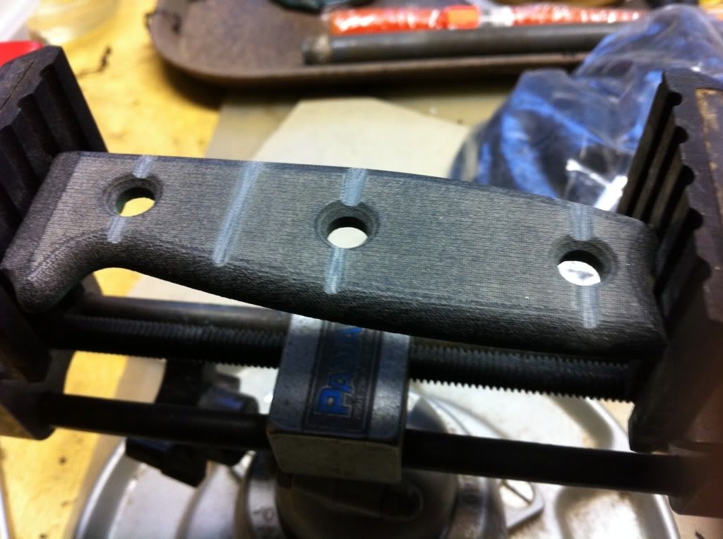

Now I'm working on the 6
*****EDIT*****

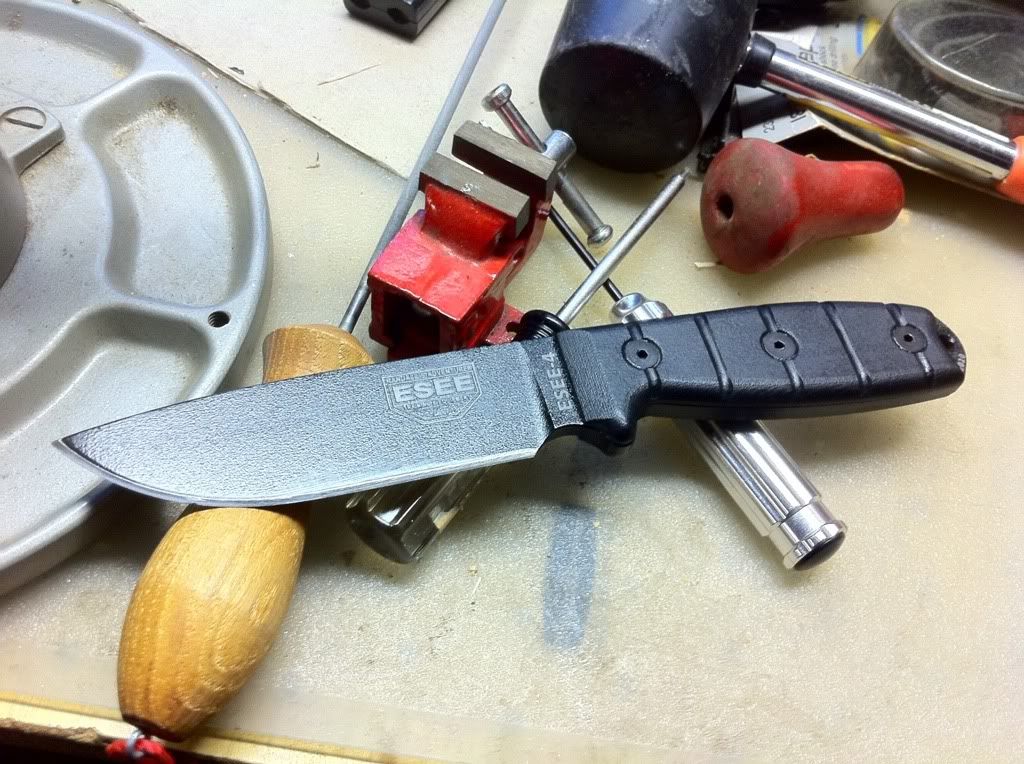

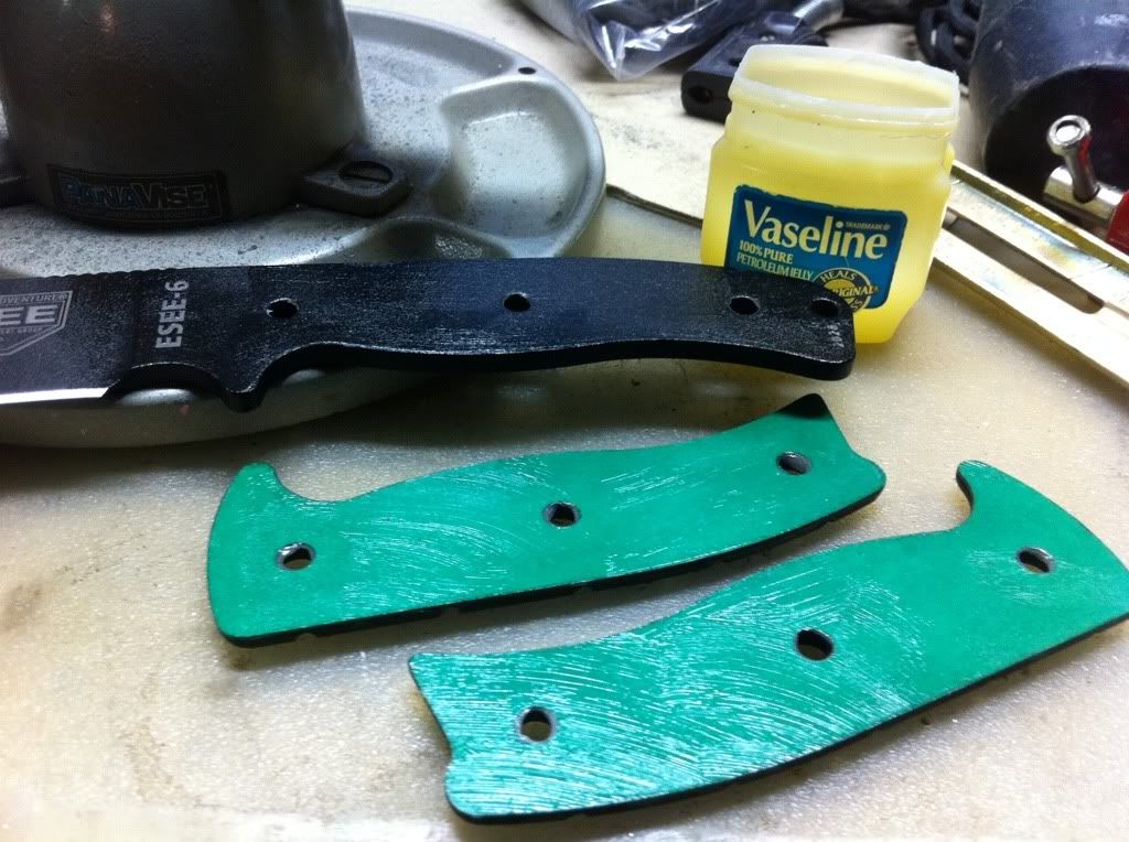

I finished the 6 in the same fashion, I'll let the pics tell the story.
I used Vaseline to coat the entire knife and it darkens the micarta, It only makes it a little slipperier in the beginning but as you use it it just feels like regular used micarta. With the modifications, even with the Vaseline on there there is loads of increased grip.
I coat the blade/ handle. let sit for a few min and wipe it off, there is barely any on there but still leaves a nice looking handle.
