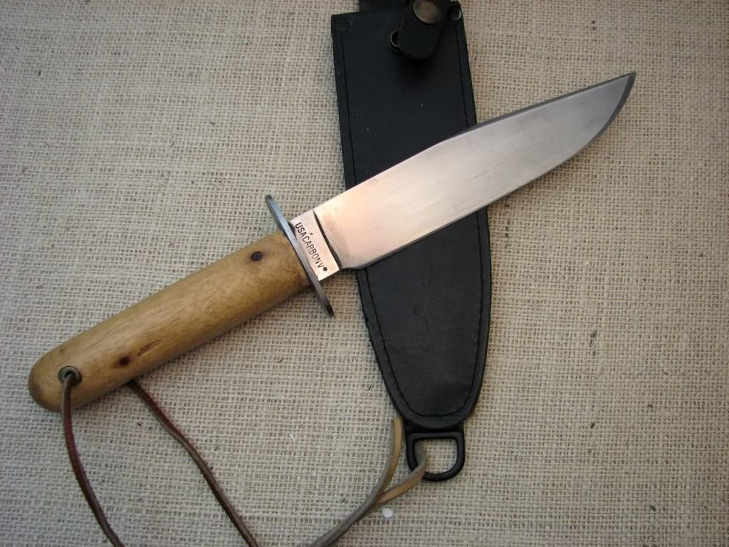

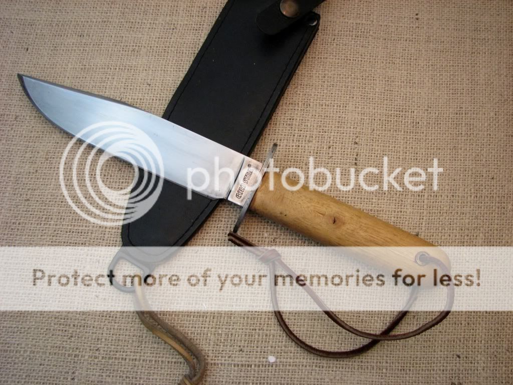

I have a few years ago
I broke the guard and messed up the handle using it for a throwing knife. Needless to say, I didn't always stick it.
So I cut off the handle rubber and took it apart. I sanded off the black coating. I used a power sander and made sure it never got warm. I had a buddy cut me a piece of stainless which I drilled and hand filed out for a double guard. Then I used a piece of hickory limb for a new handle. I drilled it out and used a rat-tail rasp to shape the hole for the tang. I measured and measured and double checked before I drilled the lanyard hole. Then I used a steel roll pin that I placed in the freezer for awhile. I forced the roll pin through the thong hole after I made sure everything would fit tight. I hammered a couple of spent pistol hulls over the roll pin and drilled out the lanyard hole through the roll pin. I also used some glue on the tang. The hickory grain on end of the handle after I shaped it on a 1 inch belt sander started to collapse, so I hammered another pistol hull in the end. I had only air dried it. It has been years ago, but I think I just used wax on the handle. I like it better now and have chopped several limbs with it. Once I chopped down a six inch willow tree. Forcing a frozen roll pin just the right size throught the handle and tang allowed for a tight fit that has never loosened.
After spending time making a new handle and guard, I quit throwing it.
