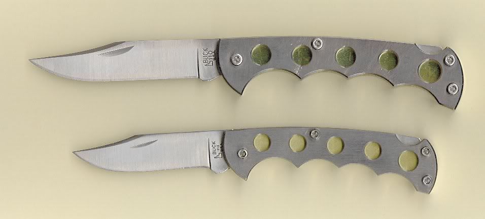

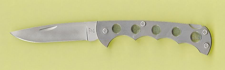

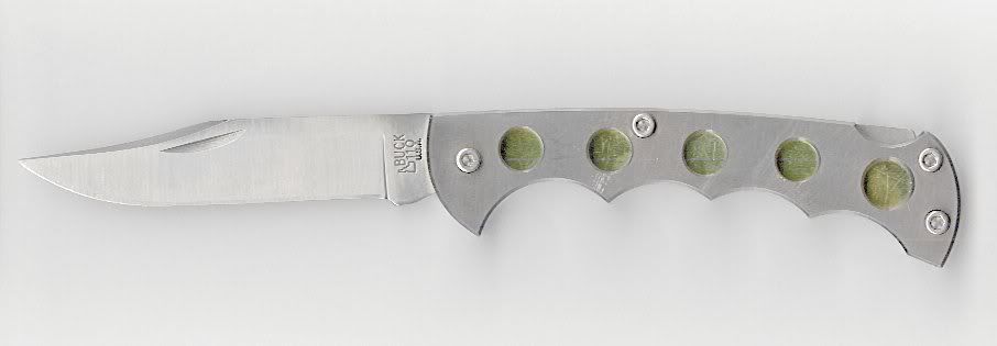

:cool:...Frank...Here's a very few of Trax's projects while still in process. He used titanium on these and didn't exhibit any love whatsoever for working with it all he while he did it...LOL...:D
