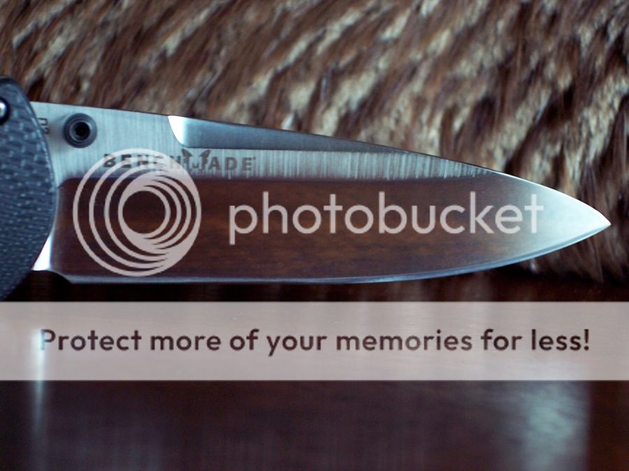

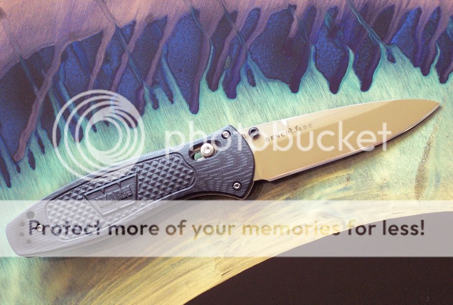

I'll use a bench grinder for roughing spines, but e'thing else is handsanded. This a Warn 583-1 tanto, after flatsanding to a spearpoint:
This was my first attempt and as you can see I slopped high a bit, I've learned to be much more careful (and have done several since).
