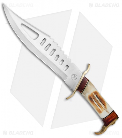

I guess the other relevant question would be how much weight can you realistically expect to drop by adding a fuller to that blade?
Now doing this would drop some weight...
I would think that a flat ground blade would save near as much weight, while looking nicer and cleaner.
