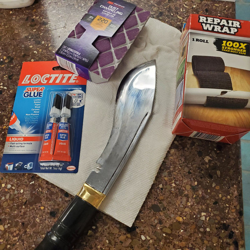

First, here's what we had to work with:
Run of the mill PK. A bit over 12" and coming at that ounce per inch sweet spot of 12oz. The swirls on the blade are from the oil left on the blade for shipping.
So this is what I figured I would need: Sanding sponge to rough up and buff, Super Glue to modify the scabbard and fill any potential cracks in the handle, Fiber Fix for my handle wrap. LOVE my Fiber Fix.

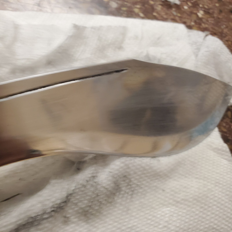

I couldn't really capture it, but this where a pinkie nail size scuff was on the blade. I took care of that with the next step involving a sanding sponge;)

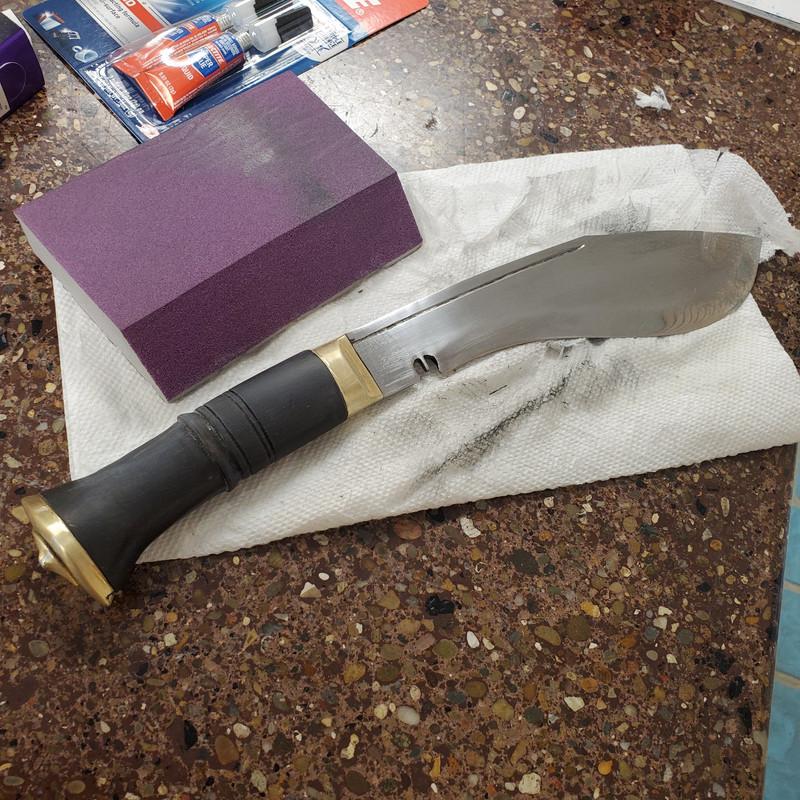

Buffed the whole knife satin. The sanding roughed up the blade to let the bluing compound soak in and made the handle grippy enough for the wrap to take.
This process actually took a couple of steps. I did a series of bluing, buffing, and acid soaking. This was during the last bluing process before I buffed the blade with high polish scratch remover.

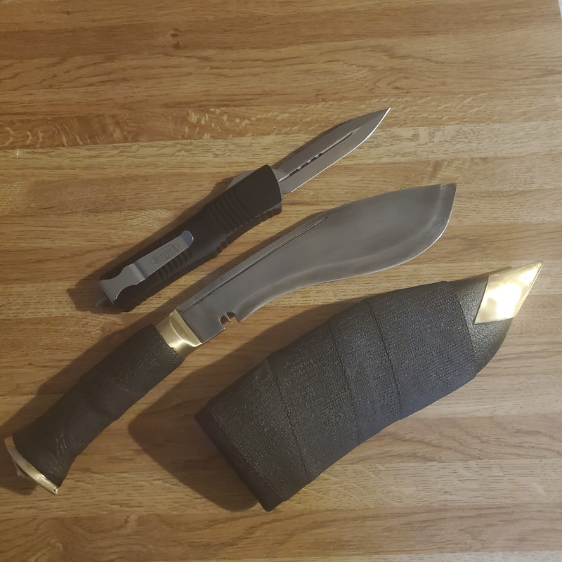

I skipped a few steps to get here, but I was multitasking at work. The finished product. PK wearing a buffed satin patina, scabbard has had an elective surgery to remove the frog and karda/chamka slots, the handle has been wrapped in Fiber Fix to stabilize the horn handle and keep it from cracking (think skateboard tape that sets up like a plaster cast on steroids). The scabbard has been wrapped in Fiber Fix as well to not only make it grippy as to hold tight in a sash-style carry (tuck n go), but it makes it nearly impervious to cutting through.
Basically what I was left with was a bombproof set up where the knife handle is stable and very tactile in the hand despite how wet it is. The scabbard has been made more resilient to cutting damage and now grips the sides of my nylon belt making it possible to carry the PK without a frog and loop.
I was really happy to see that this particular specimen of PK sports Kumar's keen yet robust edge over my old PKs overly obtuse convex edge. It cuts, slices, and chops just fine. Even after all the sanding and buffing, the edge popped back to more than razor sharp with a ceramic rod and a loaded strop. It is 100% ready to go.
