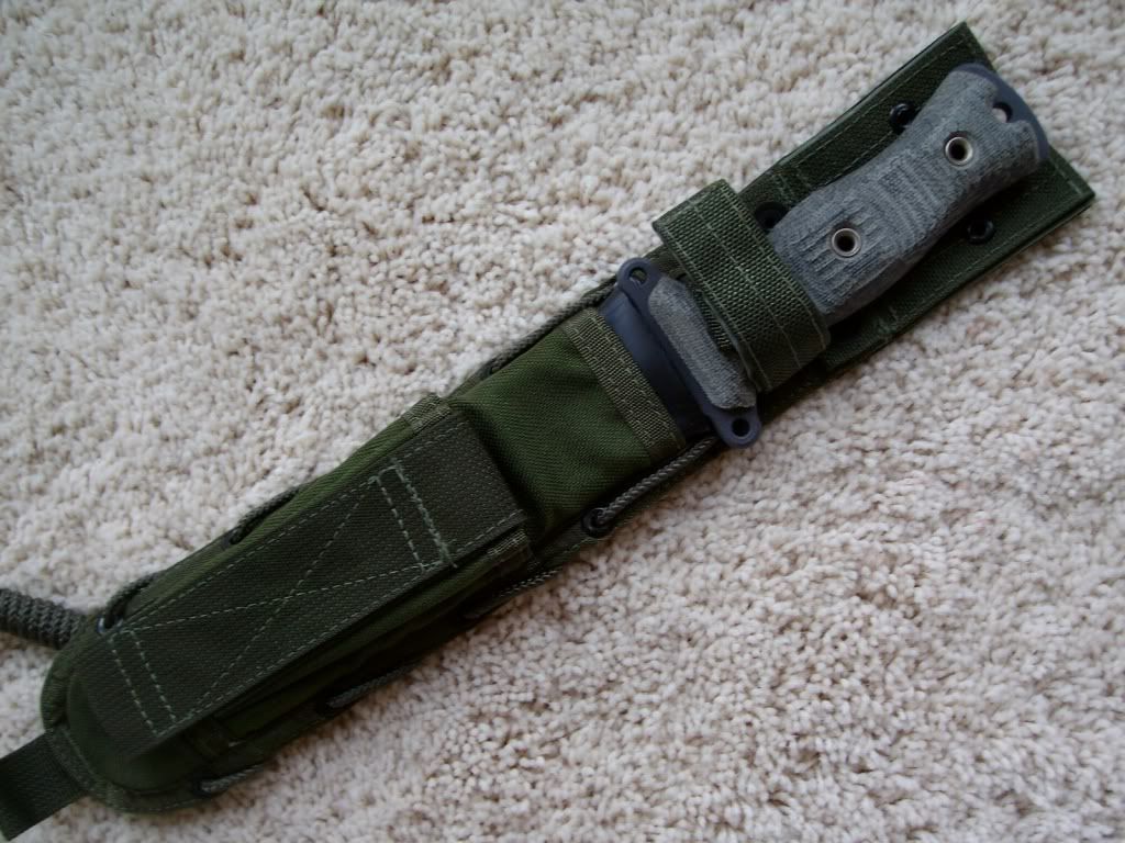

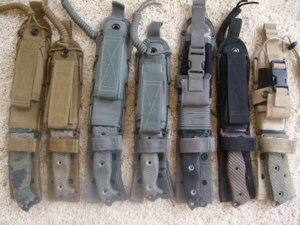

Here are some various busse's and rats I"ve converted Spec ops sheaths to fit. It's amazing how that plastic will stretch when heated; just make sure you do wrap three layers of duct tape around your blade to make it just a wee wider than needed so when the plastic hardens back, you will have some clearance and the plastic won't "grab" your blade and then your stuck.
this one was a pain, had to redue it about 3 times to get it right.. as you can see by the plastic sheath at the top, it is very hard and shiney from heating. but it works.
