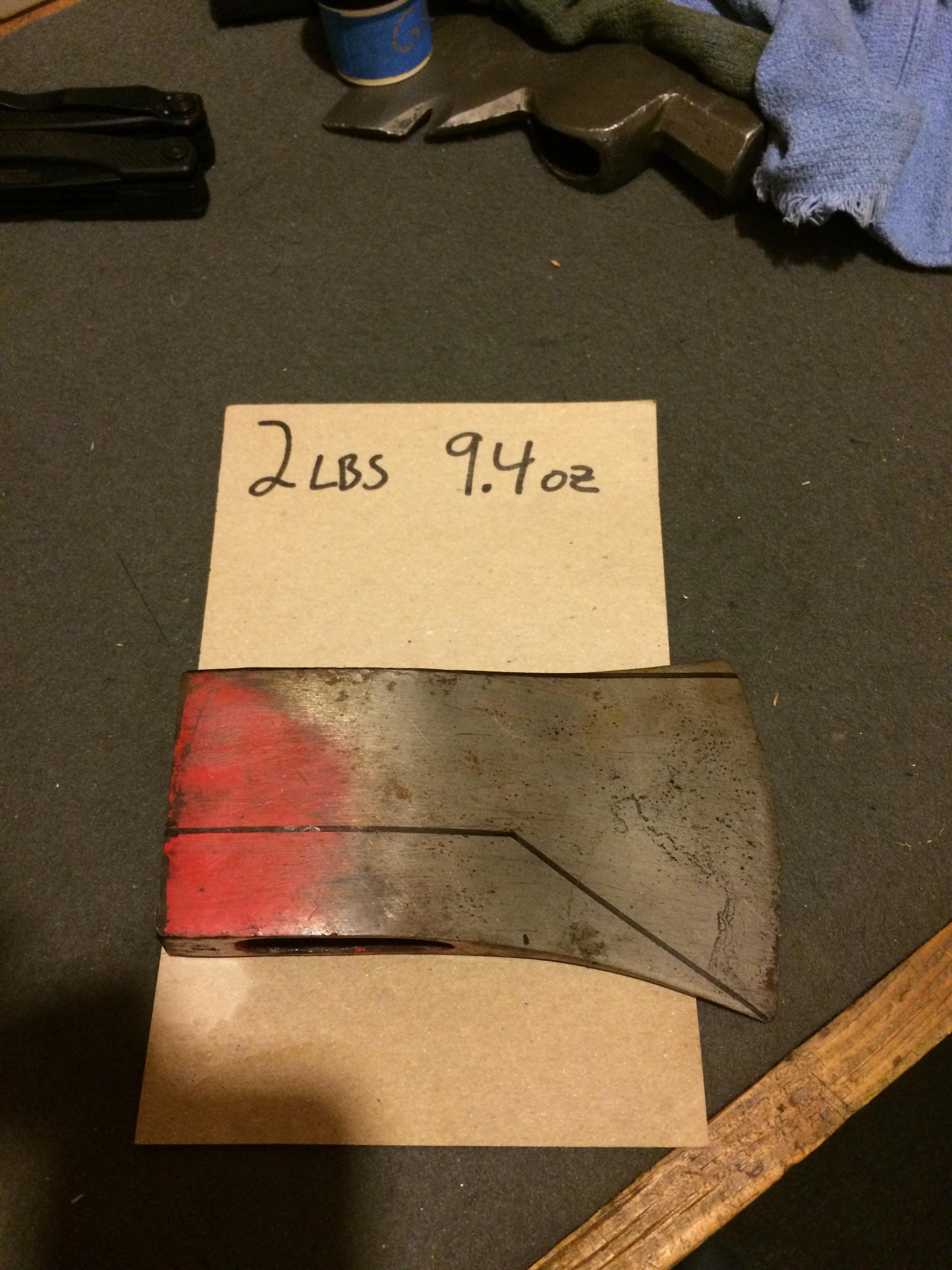

I've had this axe head for years, got it for free. It was left in a house I bought.
Seems like good steel, but no maker's markings, although you can see where a sticker once was.
Always liked the looks of the Nordlund axes, so I decided to mod this one into a similar design.
The head is starting out at 2lbs 9.4oz.

You're taking on a big project. I can't wait to see the results. Keep posting photos of your progress.
Its begging to be a pickeroon.

Naw, your reading way to much into it. I just thought the waste piece looked like a pickeroon.
I don't think a jigsaw or bandsaw would cut the bit in it's hardened state. You'd have to anneal it, then cut it, then re-heat treat it.
I've had good luck using a dremel and a stack of cut-off wheels. No issues with the steel overheating.

Looking at the picture of the proposed cut I now see what you mean; the leftover piece ought to make a half-decent pickeroon.
I've done this a couple times, the heat issue is easy to overcome. I'll be looking forward to the final product.
Curious, did you make the cuts in stages and somehow quench every 20 seconds (roughly)? That was my best guess...a tempered axe head is to large to rig a heat sink (at least in my limited experience). I imagine I'm not the only one who has wondered about this.
I wrap the head in water soaked shop towels and clamp them on, then have a bucket of water at the ready. I dip rags, clamps and all. Cut with an angle grinder and cut-off wheel.

It may kill a band saw blade. Atleast the bit part.
Looking forward to the pics!
You could cut through the bit with a cutoff wheel using water to cool and then finish it up with the bandsaw.
When I use the little dremel with a cutoff wheel I haven't had any issues with heat. The area of contact is so small with the little wheel that there just isn't much heat produced. I will go through a number of wheels cutting one axe head though. One issue with the little wheels though is you have to attack from several angles and often the waste section ends up cut into several pieces (so in the above plan there would be no pickeroon left over)
