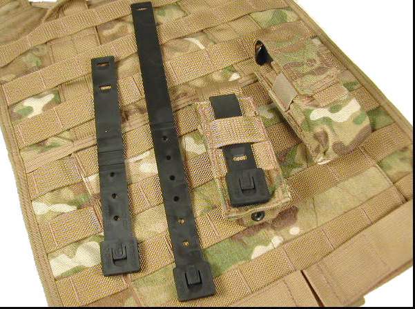

We received an email stating the snaps would not hold on the MOLLE strap. If you use a MOLLE system you MUST thread it properly or else the snap can come apart if the sheath gets caught on something, or by simply pulling on the sheath. The cross straps are on the MOLLE back for a reason. See this:
Excellent picture Jeff ,:thumbup: Some Folks are Visual learners,did not know this was a issue but Cleared up with a simple picture !;)
Excellent visual - the weave is very important.

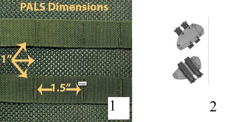

I have a question for you guys. I'm getting the tan RC-3 once it becomes available and I just got a tactical backpack with PALS webbing all over it.
What is the width of the strap in the back of the molle sheath? I want to make sure it'll attach to the backpack.
Also, do the RC-3s come with the molle locks in picture "2". The RC site lists "Sheath System w/ MOLLE back and boot clip", but mentions nothing of the locks.
Thanks!
The MOLLE strap on the back of the sheath is s shade under 1" and threads snuggly through standard MOLLE systems like the one you have pictured./ The hard MOLLE clips like the ones you have on the RC3 sheath are 15/16" and also thread through standard MOLLE systems. Mike
