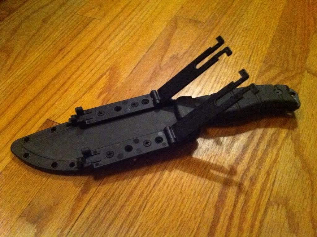

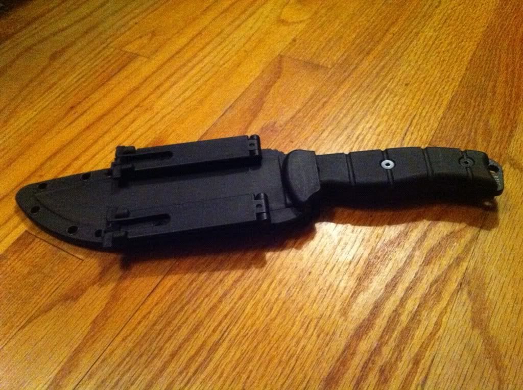

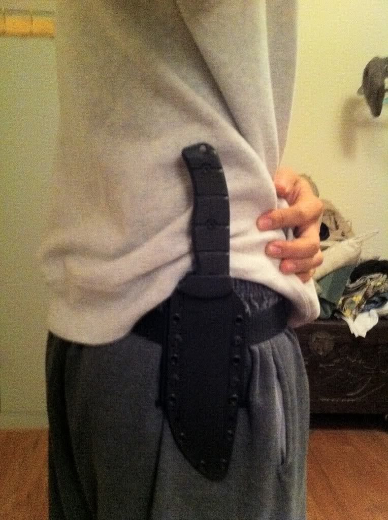

Hello again, as I was experimenting with the Mollie locks I , as well as many many other people discovered that they don't exactly mount very high on the sheath, this causes the knife to become "top heavy" when mounted to a belt, pack, etc... My solution to this problem is to drill some extra holes in the plastic between the existing holes... This allows the mollie locks to be mounted higher than they would normally be. Ultimately, they could be mounted even higher but my OCD caused the drill to touch center between the existing holes...
What do you guys think?
