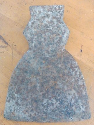

We went to "the lake" for opening day of fishing season which hapens to be where my parents live. I spotted this head on top of their dog house and asked mom about it. She replied with something to the effect of "oh I found that when I was rummaging around in the green shed". It is a green metal shed that has been moved around the property since back when my grandfather owned the property. It must have been my grandfather's since neither of my parents remember it. They gave it to me in this condition.
It measures 7.5" long and has a 5.5" bit that is double beveled. The eye is hatchet size.

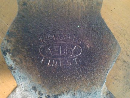

It is a Kelly "The World's Finest"

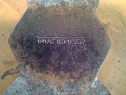

With True Temper stamped on the other side.
This thing is in fine condition aside from some light pitting. I doubt it was ever used much. It certainly was never hammered on and will make for an easy resto project. My problem is I am not entirely sure what it is. Kent pattern? What haft would be appropriate and how long? I am thinking 18" straight haft. What would the intended purpose of a head like this be? Is it basically a double beveled hewing hatchet? And what should the profile of the sharpened bit look like?

That's a hewing hatchet, probably mid-century. Great shape too. I'm not sure on the handle length, but you are probably close to where you want to be. These are for control more than power. What does the head weigh, 2lbs or so?

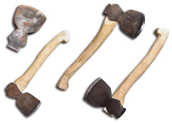

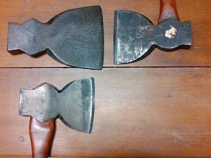

I am not sure what the head weighs since I do not have a scale. I do know it is quite a bit larger than my single bevel hewing hatchets as seen below.
Can't quite see but it looks like it still has a nice single bevel profile on it.
"a shaper not a chopper"

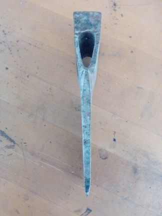

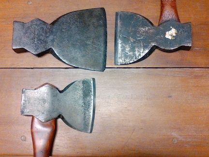

It is most definitely not a single bevel, nor was it mistakenly ground into a double bevel by someone that didn't know what they had. I have seen plenty of hewing axes/hatchets ruined by someone grinding the flat side of the chisel bit to turn it into a piece of scrap metal. It came from the factory double beveled and both sides of the edges of the cheeks are also beveled exactly the same way. It is not flat on one side like my hewing hatchets. As illustrated by the picture below you will see that the head looks the same as in the picture above except this side has the True Temper stamp on it.
Then it looks like it's a New England or Kent pattern center-bevel axe. Sweet find, that's in gorgeous shape! Didn't know TT made those.....

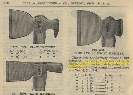

I would probably call it a New England pattern broad hatchet. Very similar to one listed in the old AA&T Co catalog on page 97.

Here's that picture from the AA&T Co catalog (showing the New England pattern):
Thank you for the picture Steve.

Indeed. It does appear to be the less common double bevel from the factory. In your 2nd photo the shape of the cheeks just forward of the eyes confirms this. It's double beveled there. Single bevel hewing hatchets are flat on one side there. I'd call it a New England pattern hewing hatchet. Great find!
