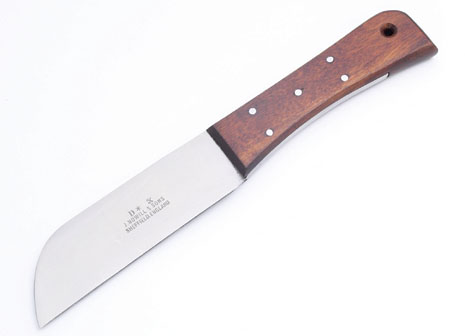

just for interest the original is from sheffield knives here in the UK and is from their seaman's line, this one is the master mariner's knife with marlinspike ($50), it's geared to the bosuns and riggers amoungst us....i have one of their carbon steel seaman's knives as my normal edc around the house. see www.sheffieldknives.co.uk for more drool prompters.
the youngster's of course has the benefit of being custom made & also made with affection and emotion behind it, rather than by a soul-less machine stamping them out by the hundreds.....his is priceless....that is the magic in the blade that cannot be factory produced. it's also carbon steel instead of soulless 420 ss
They don't list a lot of unnecessary info on the Sheffield website for this one, like blade length, handle length, etc., but I liked the basic shape and thought it would be a fun one to make. Mine has a 4" handle, and 5 1/2" file steel blade, just a skosh under an inch wide (15/16") and just a skosh under 3/16" at the spine (5/32). Went with just a slight clip on mine instead of their bowie style clip. Handle is full tang, Bolivian rosewood slabs, epoxied on, then hammer riveted with solid brass pins.
I borrowed from their pattern, but I obviously applied my own interpretation. Didn't feel a need for a lanyard hole on a knife with a bird's head grip. If I need to attach a lanyard, I can take a length of cord, tie a constrictor knot around the bird's neck, and tie the two loose ends together with an overhand knot to form a loop, piece of cake, one lanyard coming up. I also didn't like the flat sided, kitchen knife look of their handle, presumably to keep the knife from rolling on the deck. Tested mine, it doesn't roll, and there's not a flat surface or sharp edge anywhere on that Bolivian rosewood. Comfy grip, and solid too, I slathered it with mineral oil and set to cutting up rope, cardboard, and stuff to check the "slippery when wet" factor. No problemo :thumbup:

Like the knife a lot - as noted, sweeter to my eye than the original.
I like the sheepsfoot rigging knife on the site too.
I like that one Sarge. Thanks for posting.
I like it too, probably going to make one, and other than running my tang on out the full length of the handle, I don't see anything I'd want to change about this one.
It looks "Sheeple" friendly and wouldn't get you flogged for toting a weapon aboard a ship of the king's navy.
Sarge
In traditional seamanship, that dead straight edge on a rigging knife's blade is important. The traditional way to cut a thick rope is to first do a whipping just behind where you'll cut, then baton through the rope with a single whack ... the flat edge means you have no threads left unsevered. Some prefer working a bit more knuckle space under the handle, so if you do that batoning on a flat board, you won't ding your knuckles.
