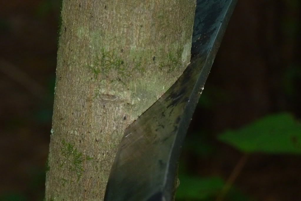

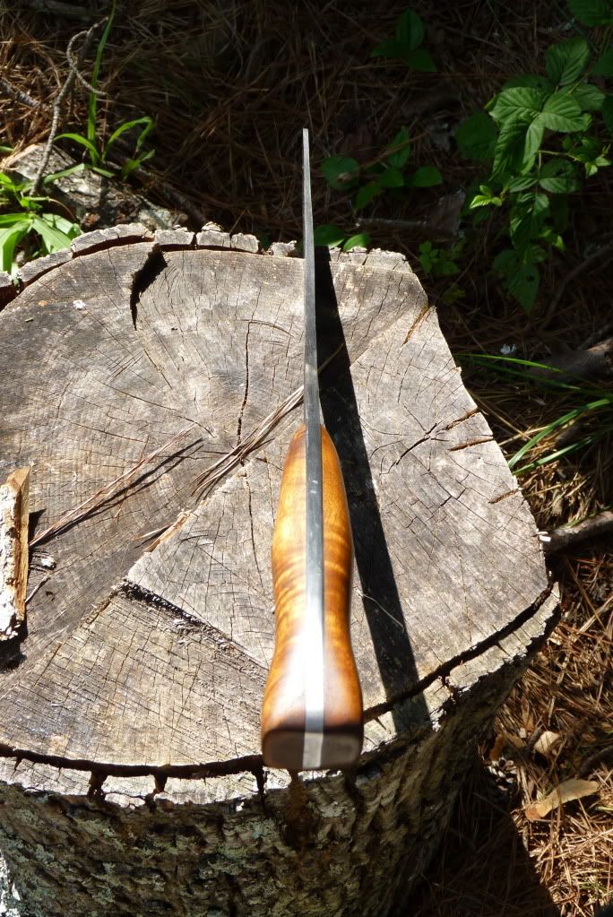

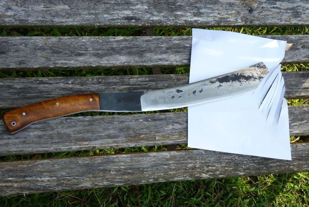

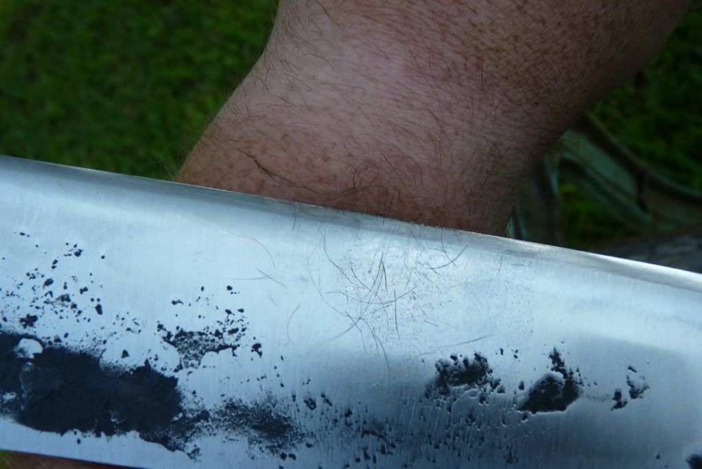

I finally finished my monster chopper.If you remember my first thread it's forged from 5160.Here are a few pictures of it in action.http://
Razor sharp paper cutter.

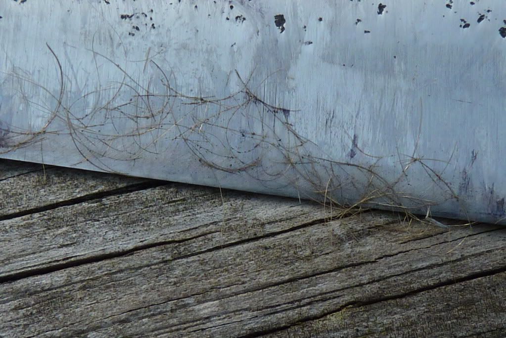

Shaves arm hair like a straight razor.

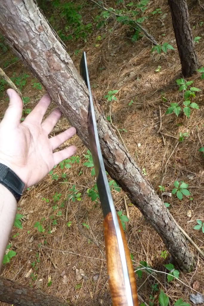

One swing in a small pine.

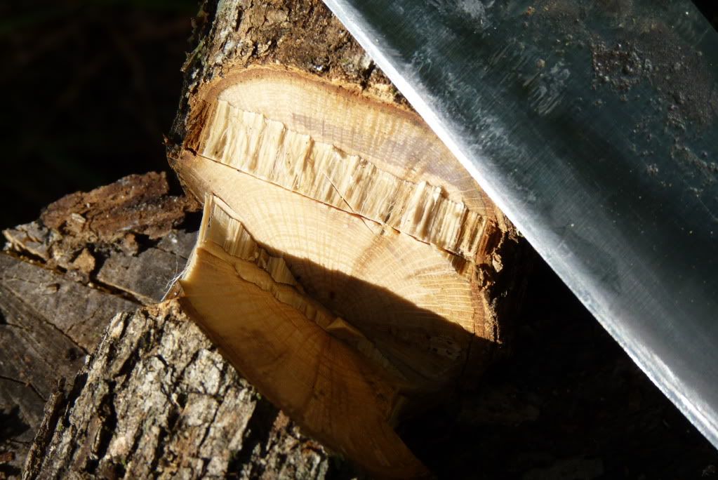

4"hardwood,no problem.
I really like it. So out of curiosity what hardness is it? I only ask to gauge the ability to shave after chopping. Aso what's the thickness on that beast?
It's a hair over 1/4" at the handle tapering to 1/8" at the tip.I didn't test the rockwell but I normalized it three times and also quinched it 3 times.A new file would barely mark it as quinched.Then it was tempered at 400 degrees for an hour.You still can't sharpen it with a file but a few strokes on a loaded strop is all it takes.
This was a test piece to see how far I could push a big heavy chopper with a razor edge and still have the edge hold up under heavy use.So far I love it.
Here is a picture of the just forged blade next to a Condor 18" Eco Light to show the size.http://

That is one sweet chopper. That was one swing into the pine eh? Damn that blade is buried. What is the weight? If I missed it my apologies...BTW the handle looks sweet too!!!

Sorry,I don't have any accurate way to measure weight but it is close to my 2 lb hammer just by feel.
