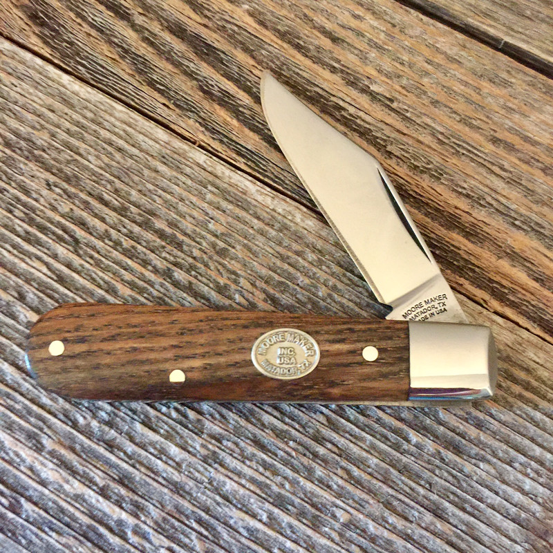

I was getting a few questions on this knife, so thought it would be easier to post a nit-pick review. First of all, I really like the knife. It has a rugged hand made quality that is very appealing. That being said, there are a few Fit and finish issues on the knife. It operates properly with a nice strong pull and good strong snap. The blade is mostly centered but does favor one side. the handle/bolster transitions are smooth as are the pins. Over-all, I really like the knife and the price was about right for what you get.
It's a good looking knife with its Ash wood and clip point blade
I really like the hidden tang

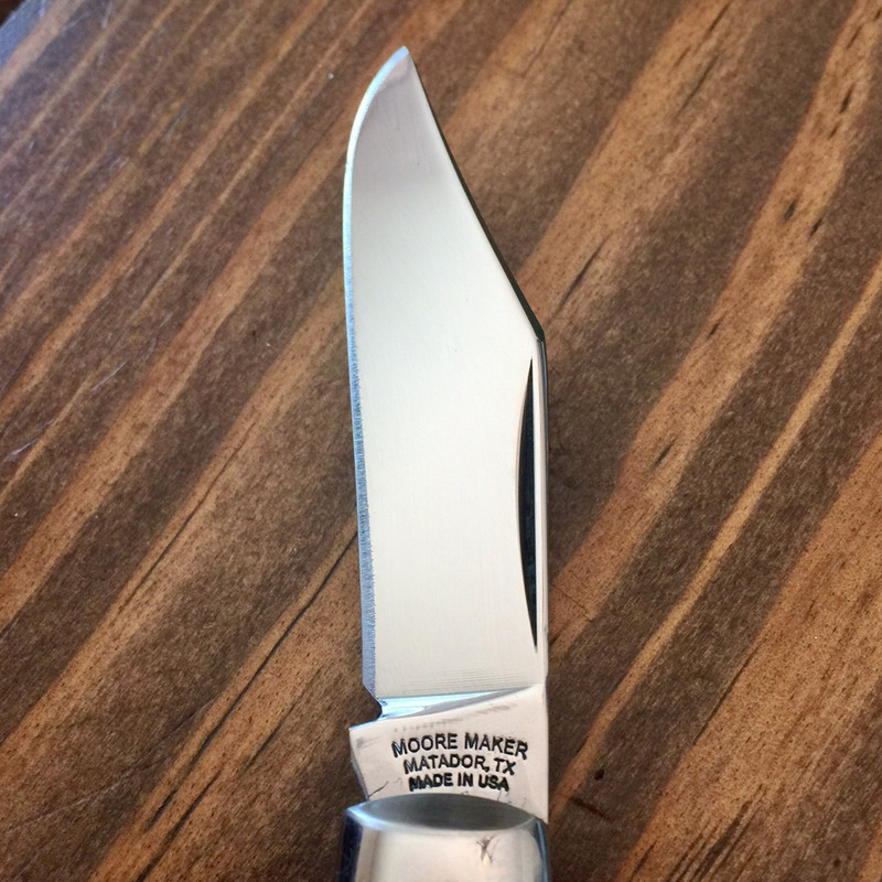

The Mark Side of the blade is highly polished

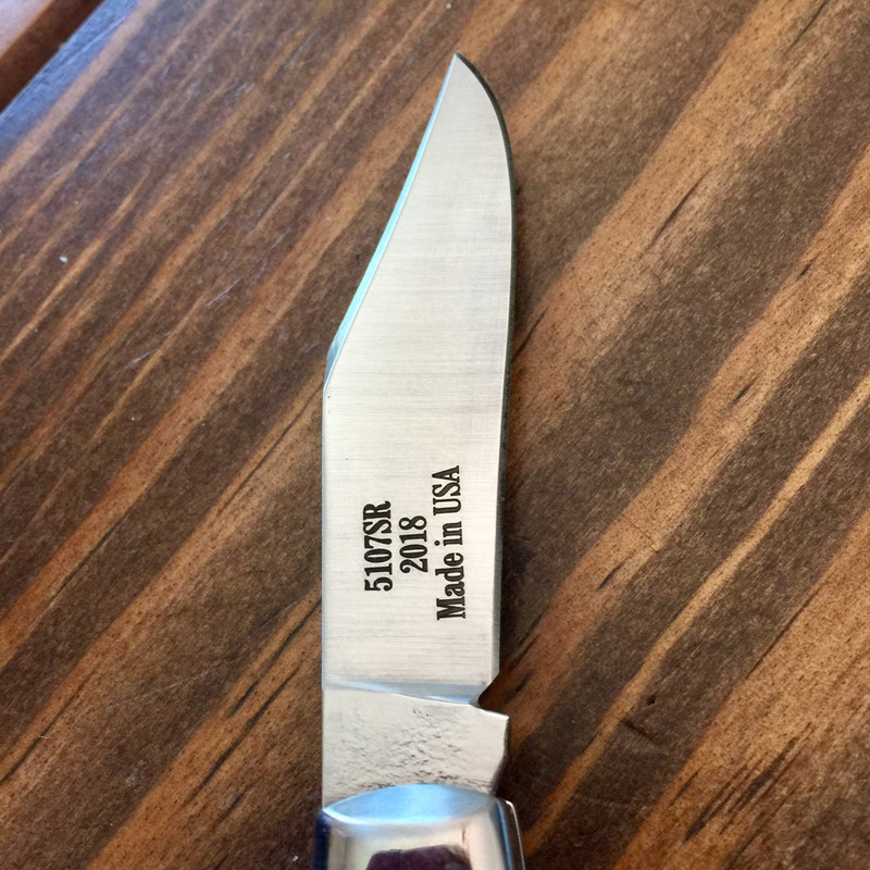

The Pile Side blade is more "as ground"

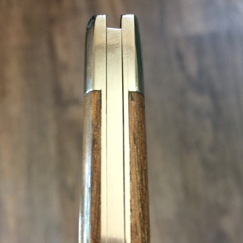

There are some gaps in the liners (first nit-pick)

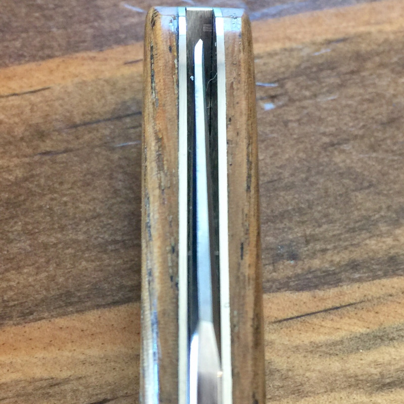

And the blade is not evenly ground, notice the swedges and tip (final nit-pick)

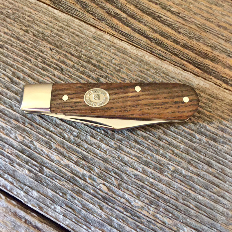

Oh ya... a final nit-pick is that shield isn't pinned. :mad:

The thing that would bug me is the uneven finish side to side on the blade.
Lots of older pocket knives were made this way. The pile side had what was called a glaze finish, done with a fine emery wheel. Thats the fine vertical lines you see on the back of the blade. The polished mark side is called a crocus finish. Its pretty much a mirror finish, done on a hard leather wheel impregnated with a fine polish called iron crocus. This polishing was done on the mark side so an etch could be applied on the blade.
This knife seems to be an attempt to reproduce the production methods used years ago.... The problem is, on this knife the etch is applied to the back side of the blade on the glaze finish instead of the polished side where it should be, and the polished side looks like a bad rag wheel buffing, or maybe a chemical polish that was applied before the back side was ground.....:(
