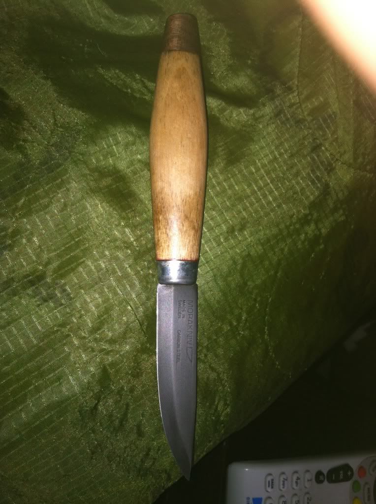

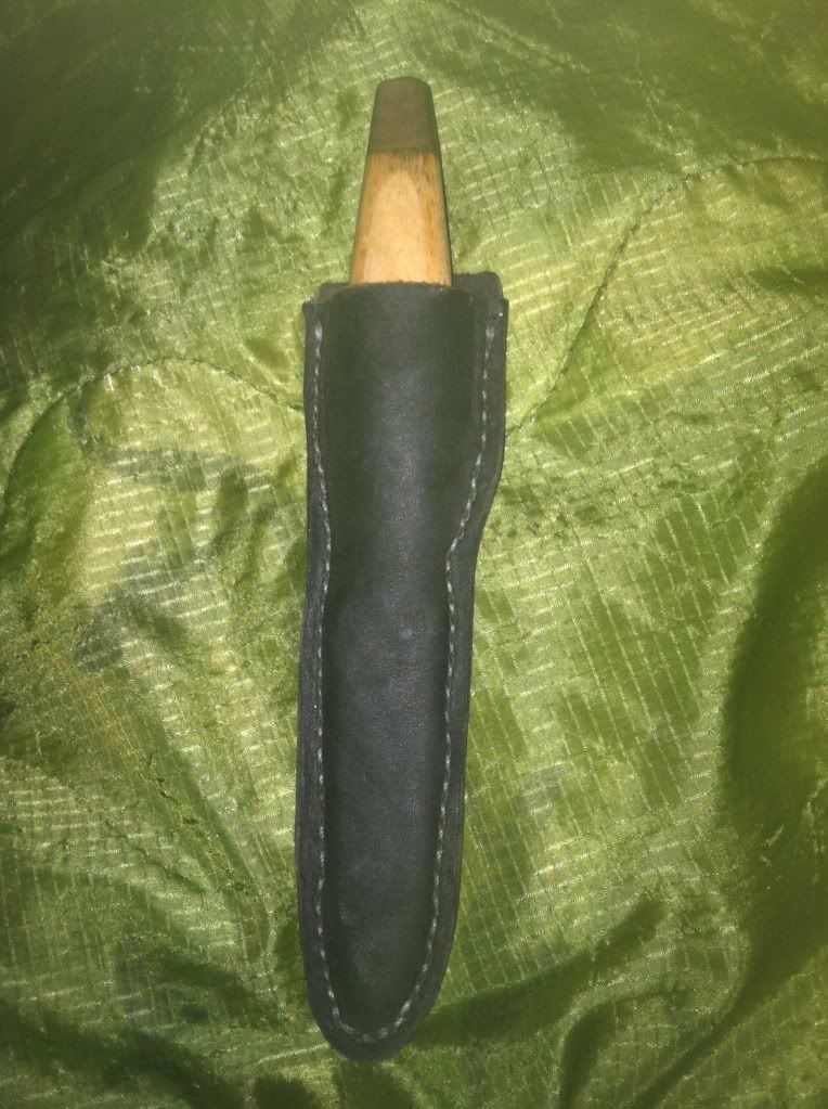

Hey guys, I didn't build this knife but I did some work to it :) I didn't like the red handle it came with so I sanded that off and glued on a walnut butt cap. Oiled and CA finish. Then I did a vinegar patina on the blade. I also wasn't happy with the plastic sheath it came with so I made this one out of leather. I cut the very bottom of the plastic sheath off and inserted it in the leather one to protect the blade ( and my leg)
Why the butt cap? You oiled it before the CA? Why not just apply the CA after you sanded it? I'm a big fan of the CA finish (many aren't). How many layers did you do?
Adding the tip of the oem sheath was really smart. I'm thinking of doing similar when I build my next sheaths. :)
Good job!
I added the buttcap to make the handle just a little longer. This knife is fairly small and it just aids in handle comfort. I put a little boiled linseed oil on it first to help all the grain pop out a little more. It gives it a slightly darker tint if you do that too. I think I only put 2 or 3 coats of glue on it. I wasn't looking for a highly polished finished, mostly for water proofing. :)

I usually just burn off the red paint, file a few treads into the palm side of the handle (mostly so I can tell what orientation the knife is in by feel), and fill the gap under the ferrule with melted wax. I like the addition of the pommel, must add a lot to the leverage factor. The sheathes I made for my 2/0 and #1 are Kydex lined with some waxed leather. Initially the one for my 2/0 was supposed to be for my #1 but was a bit snug - had to grind it down and make a larger one. Used aluminum nails and heavy copper wire for the rivets. Left the 2/0 as is but treated it with a bit of mineral oil, the #1 is coated with polyurethane and 400 grit SiC blend.
