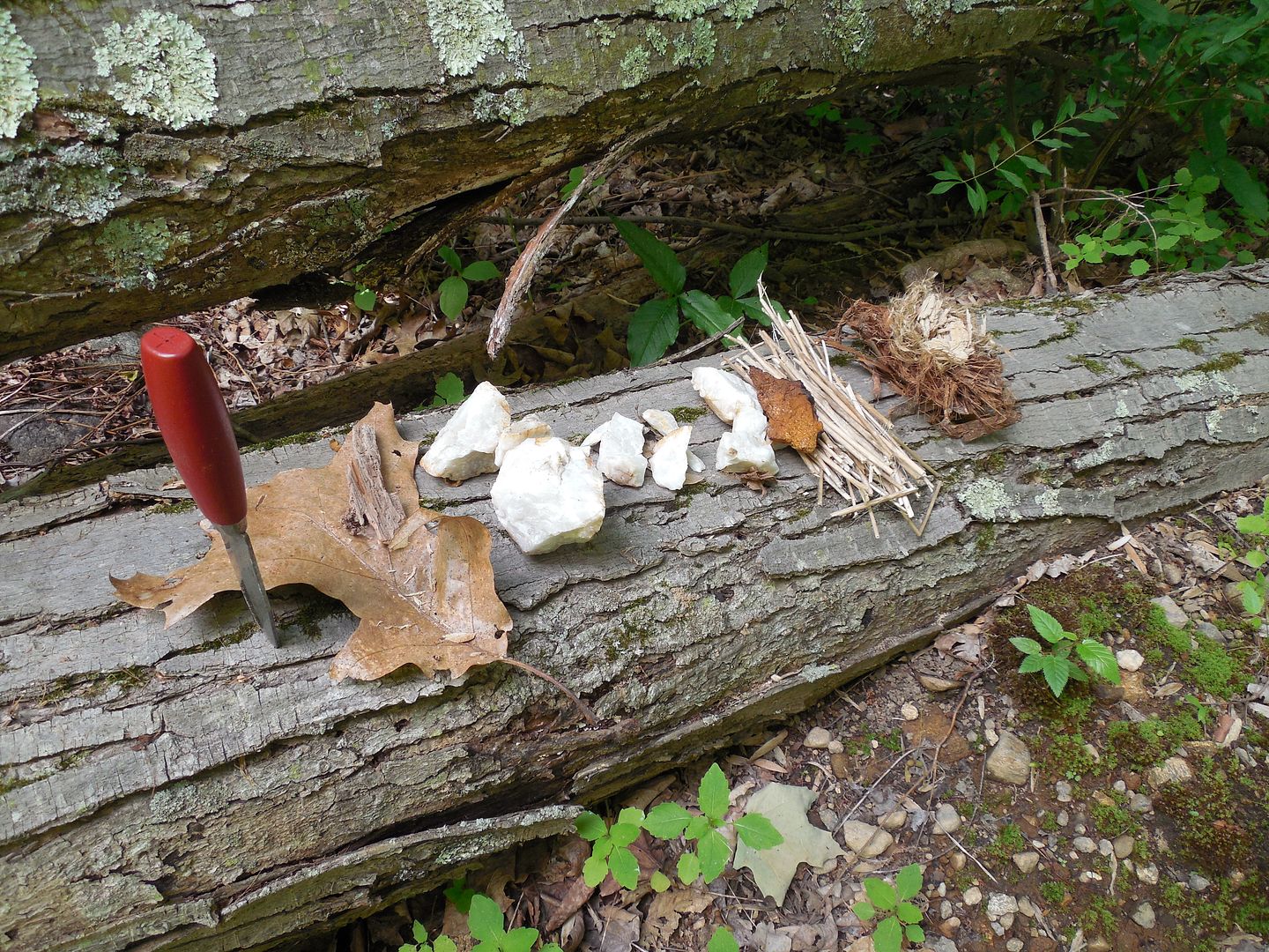

I already knew the chaga would catch a spark but didn't pack a rock, tinder, coal extenders and whatever else would be needed beyond the knife and fungus. First order of business is a rock. Found some quartz in a drainage area. Used a special knapping method called "drop big rock on small rock". This is the results of years of practice. Complex physics like the effects of gravity on objects must be first understood before attempting it. These broken quartz rocks were left in place. Would come back for them later.

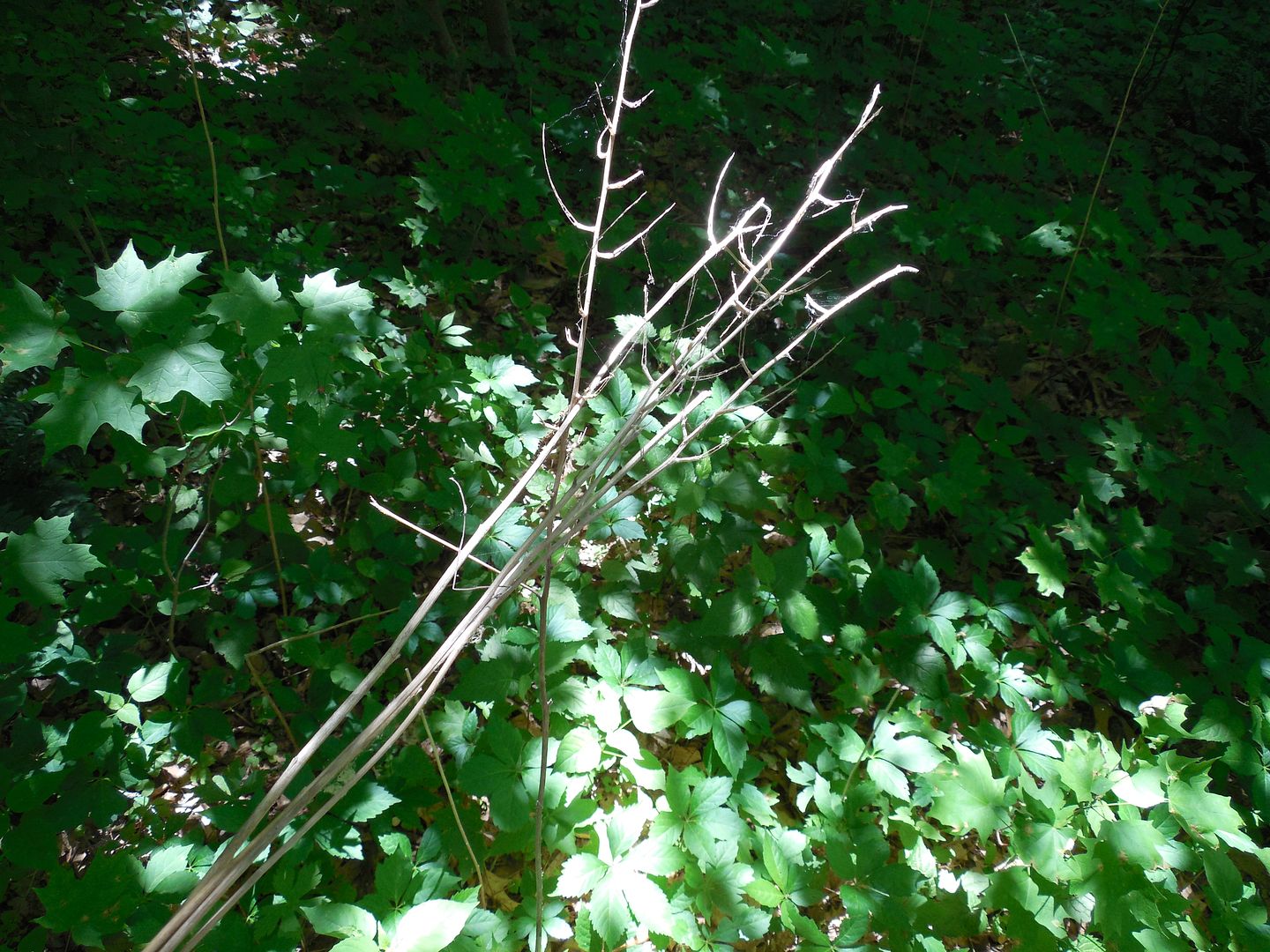

Found some of this hollow dry weed. Didn't know if it would be good in the tinder bundle but what the heck.

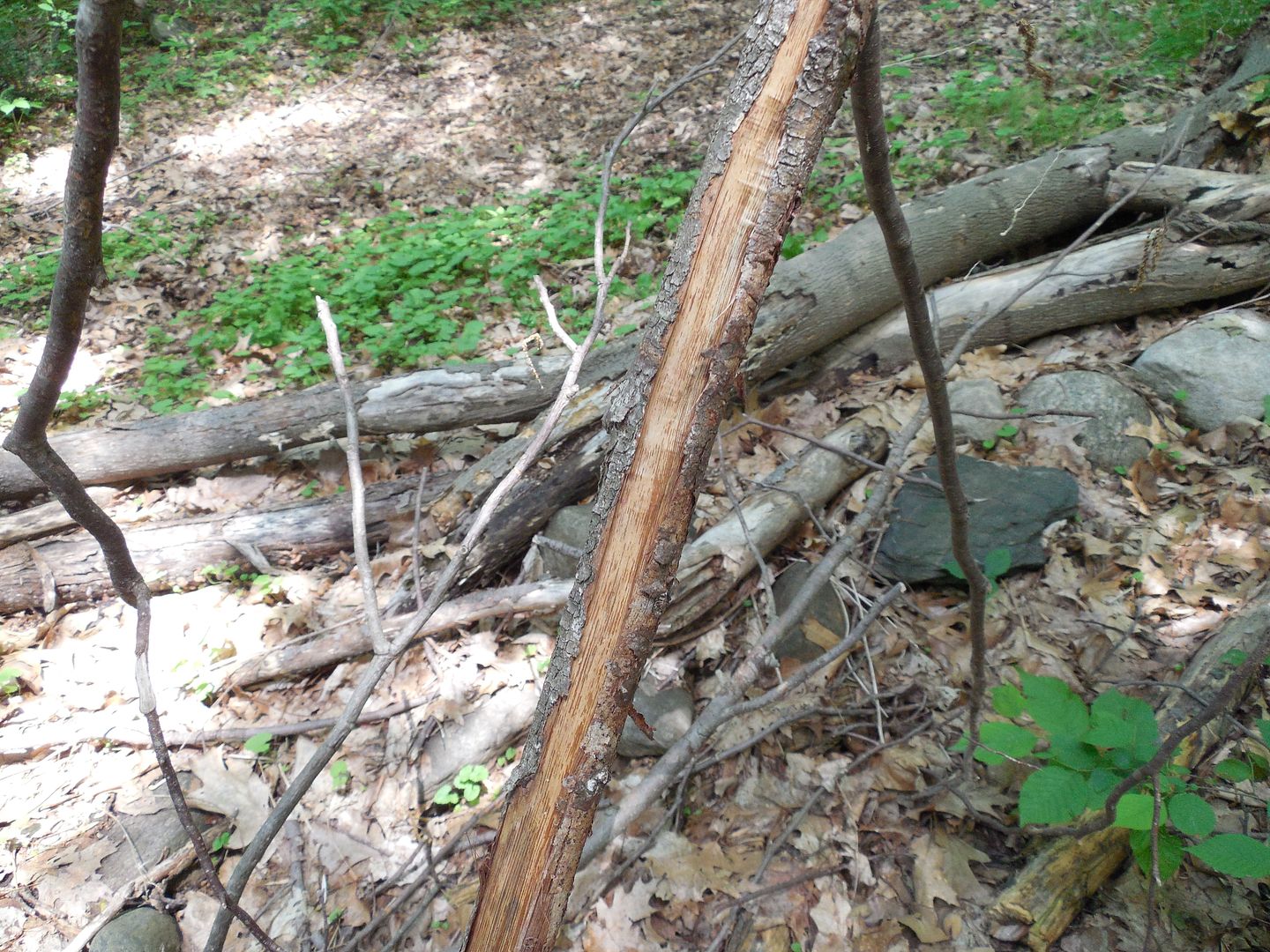

Stumbled on some dry tree bark. Not sure what that was but found some dry hickory bark as well. Going to fluff up the bark from the dead branches for the tinder bundle.

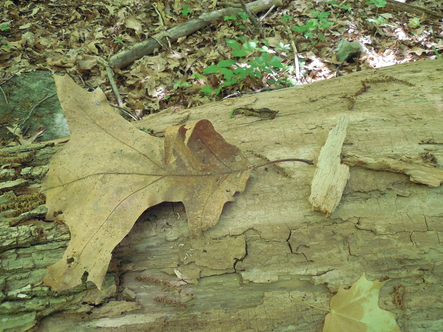

This punk wood will make for a good coal extender. The chaga is also a great coal extender but punk wood is easier to find. Punk wood can make the coal large enough to ensure the tinder bundle will ignite. I had plans for the large oak leaf.

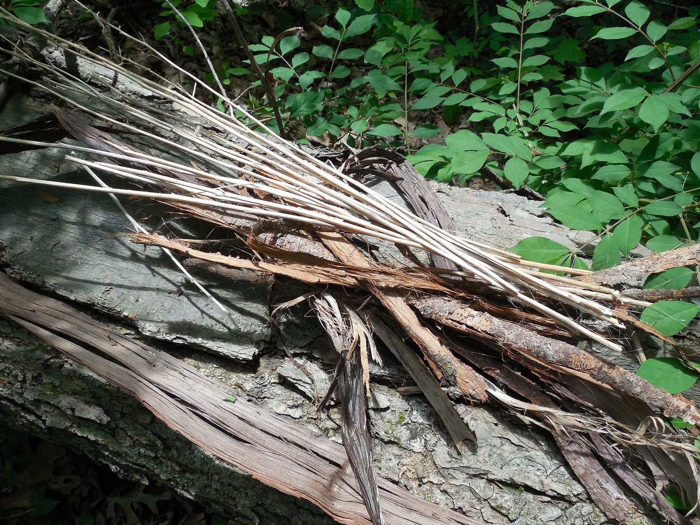

Working on the tinder bundle. The redish bark just fragmented up. Not all that fluffy however the hickory bark fluffed up good.
Looking good. Given the amount of punk wood I was confident this tinder bundle would burst into flames.

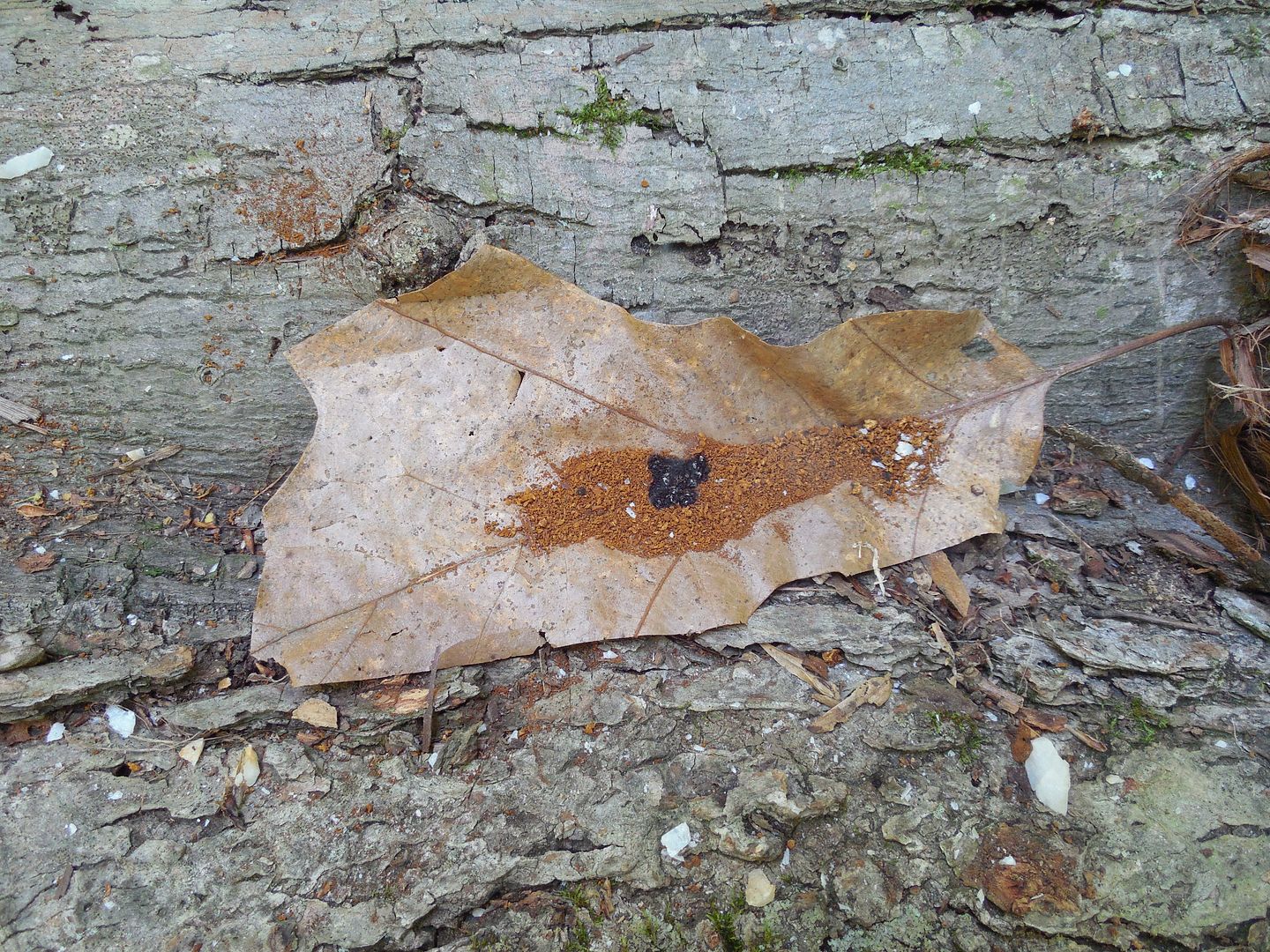

Dusted up the chaga into the leaf. The plan was to toss a spark into the dust then put the smoldering chaga into the tinder bundle. Once that was done everything would be moved to the drainage area with water. I don't have a cleared fire ring. The ground was very wet but better safe than sorry.
Maybe a minute or so later the quartz shaved off some carbon steel which then ignited the Chaga dust.
