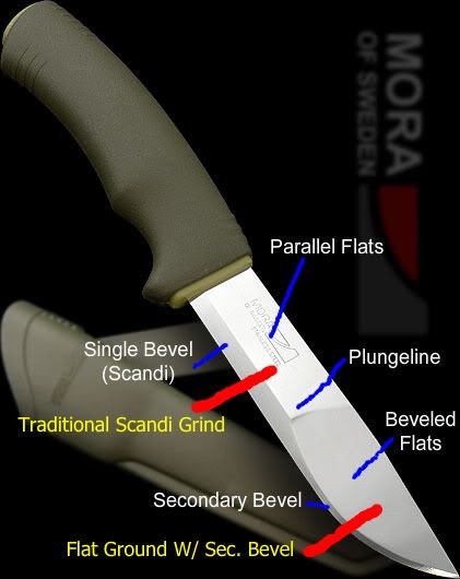

I have heard from reliable accounts that the Swedish go on many hunting trips and found that the regular Mora was not very good at spreading butter and Pate when they stopped for food so a designer for Mora came up with that grind !
I have an M2K and it's scandi ground all the way to the tip, as far as I understand grinds at least.
I may not be sure of why it is like that, but as long as you can keep it sharp, I don't think it should really matter![]()
Well I mean that's just the thing. A traditional Scandi grind knife is very easy to sharpen, but the blade in question appears to actually transition into a flat grind which is more difficult to sharpen. I am attempting to understand what pros this really offers over either a standard flat v-grind or a Scandi grind.
It's the same angle along the entire edge... Just sharpen it like you would any other scandi. Nothing to it!
Jontok
That is indeed a Scandi grind transitioning to a flatground with a secondary bevel.... from a maker's standpoint, I have no doubt.
