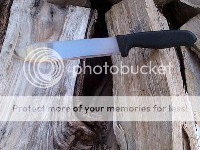

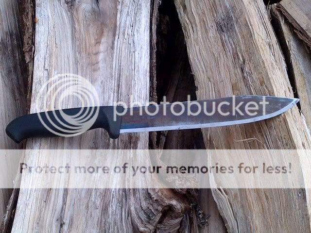

When I received the Mora 223 I was quite surprised to see it wasn't polished. It was horrible looking to be honest. I thought about it and decided to just use it as it was since it was a knife I planned to beat the tar out of. I used it once but kept thinking how good it would look polished. I had never done a polish before so I watched a video on youtube and went at it. The results can be seen below. I think I did a damn good job! If you look close at last photo you can see the wood reflecting.
I went 220, 400, 600, 1500 and finished with a wonderful wax by renaissance. The wax is way better then flitz IMO.

Before
After
Ash, in the first photo it looks almost like a blued blade, or is that an effect of the light in the picture?
Good job of polishing! How long did it take until you were happy with the finish?
Carl.
It was the heat treat and left like that. I put about 6 hours into each side. I did it all by hand. I think I did pretty good for a first try.

Looked like a crappy beater knife before the mirror polish. Such a simple thing makes it look a million times better.

Great job Ash. Looks really really nice. What polishing stroke did you use -- handle to tip/tip to handle; edge to spine; circular; or a combination of all of those.
Yea its a nice knife and batons like a champ at $18 plus shipping its a steal.
I went handle to tip/tip to handle Ed. Just back and forth as the grind was edge to spine and I was told to sand opposite to the original grind.
