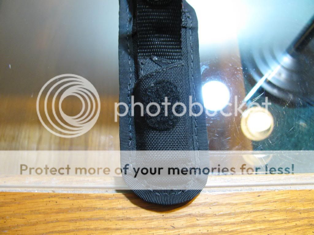

The more I use Mora, the more I like them. But the sheaths are right handed, I prefer Bic to firesteel, and ranger bands just don't do it for me. Out in my garage, I found a sacrificial tool pouch that I hadn't used in years (AWP brand from Lowe's I think). I also wanted to keep the clip mount like the plastic sheath that came with the Companion (nice for clipping to pocket and not having to remove belt) so I ordered a clip from knifekits.
I dissected the tool pouch and got to work. Everything on the sheath is hand cut and hand sewn. I stole the button buckle from a Gerber sheath. The tool pouch was made of (I think) cordura. It's similar material to what the BK16 sheath is made of, but a lot more heavy duty (maybe cause it carries a bunch of heavy tools and gets tossed around?). The material by itself didn't make the sheath stiff enough (was floppy by the handle area), so I sandwiched a piece of plastic I cut from an oil bottle inside the sheath that runs up and down the whole length.

The insert is made of kydex. The back of the sheath is made of two pieces of cordura with plastic sandwiched to stiffen the sheath up. I should have explained that better. I know bic vs. firesteel is a hot topic almost on par with politics and religion. But I'll say that if you can keep your tinder dry, I can keep my bic dry. I don't play around large bodies of water unless I'm swimming, and if it's raining, I'm not going to be in the rain long enough to be soaking wet. If I ever do get the bic completely wet, I can have it lighting again in less than one minute. I don't get the argument about lighters and water anyway, it's not like if it gets wet it vaporizes. I've been using bics for 15+ years (smoking) and feel confident in using one. I've been through that gun-ho super survivor thing before using the firesteel, but you don't get extra credit for making things harder.
