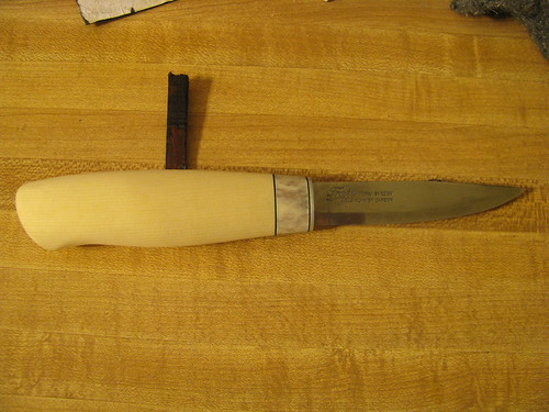

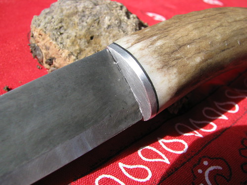

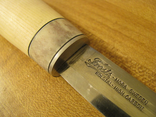

That is how it is done, and that is how I did it with these:
If you think about it, a lot of full tang knives' scales are held on mostly just by epoxy. I wouldn't question the durability of hidden tang knives that are built like this, it is a very strong construction. I use Devcon 2 ton epoxy, it gives me a half hour working time. You could also fill the handle material with melted pewter. Go ahead and try handling some blanks, it will definitely be worth it.
