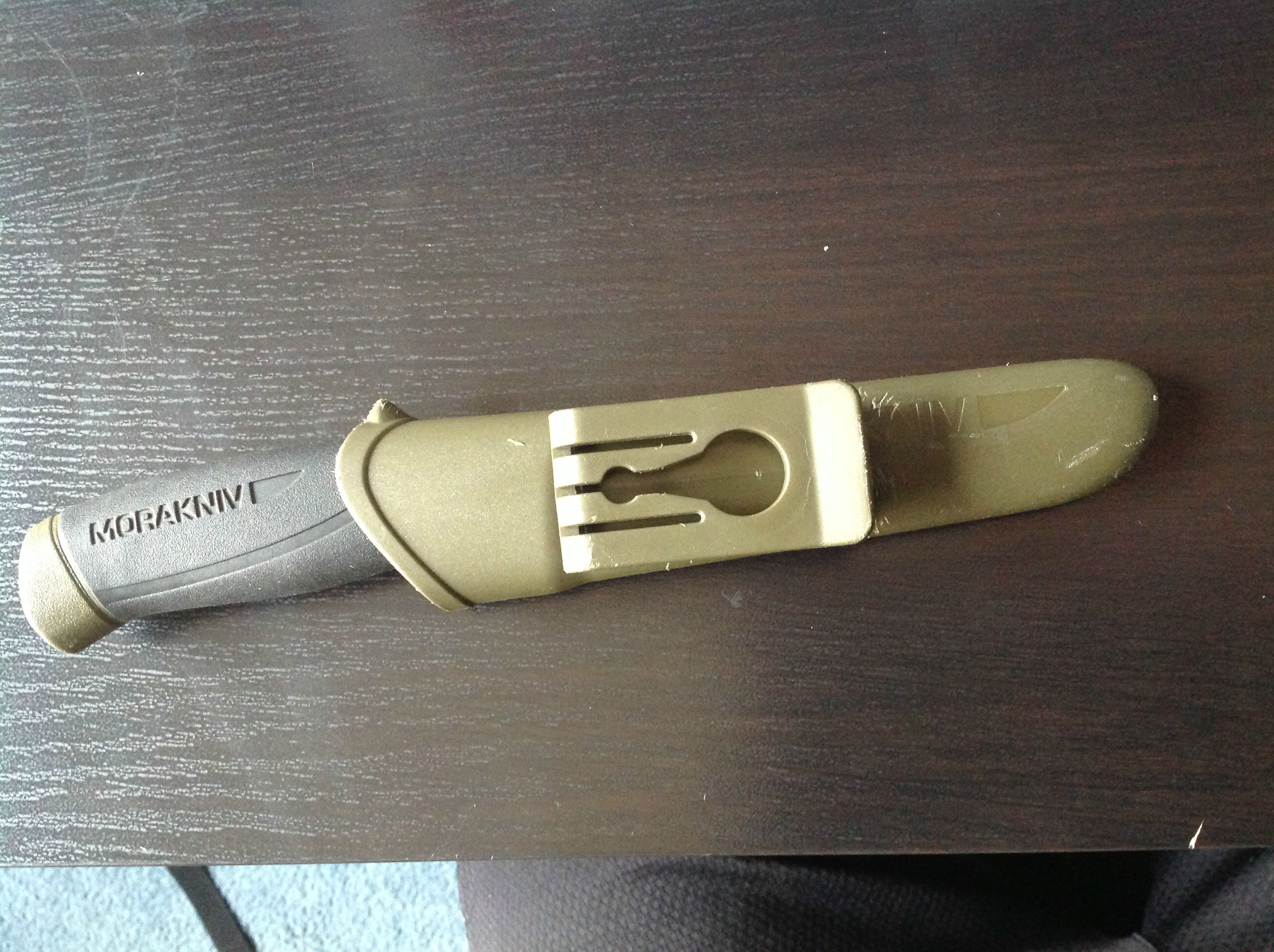

The other thing you can do if you buy one of the clippers is to cut the clip off the top of the sheath and superglue it lower to the side. A light sanding to rough up the smooth finish might help. I've done this to several of my Mora Clipper sheaths and they ride high and inside my belt quite comfortably. If you don't want to use superglue you can substitute industrial strength self adhesive Velcro.
Hey,
Thanks for the great tip. This is what mine looks like now. I plan on doing this to all my moras.
