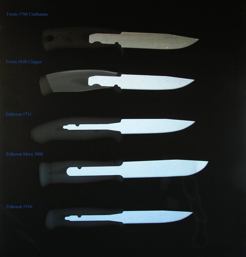

Based on this X-Ray image that has been posted in the W&SS forum a while back, I chose the #510 for the longer tang. Seems like a more robust construction than the shorter tang on the Frosts Mora. YMMV.

I'm sure the Buck is a great knife, but I love Mora knives. I have both the #840 Clipper, and the #711 from the X Ray picture, and love them both. The #711 has probably the most comfortable handle of my knives for general use. The blade shape and size is very versatile, love the steel, etc...
