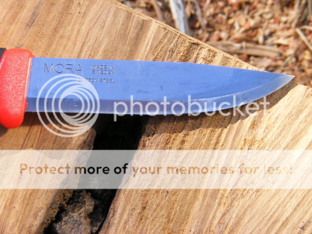

I finally got myself a mora , had to see what the fuss is about .
I am liking this knife , its just a plain clipper , no frills .
I had heard the edge they had was a scandi grind , this one is kinda hollow ground .
I was carving .. well shredding some pine into shavings for kindling just ripping shavings off a lump of pine , and the Mora lost its bite . The edge wasnt blunt , but rolled .
I shredded about the same amount of stuff with my Opinel , no problem . I steeled the Mora straight( ish ) and tried again , and it rolled , again .
I steeled it back and tried it on softer wood , and it tore that up way easier than my Opinel did .
The wood I was only pine , not iorn bark or anything .
Im thinking that it most likely is just that the factory gives the blade a bit of a hollow grind . and I have a heavy hand using it .
What I want to know .. has anyone else had this happen with their Moras ?

Mine arent deep japanese style hollow ground , but you can feel it , and see it , the stone touches the shoulder of the bevel and the cutting edge when I sharpen it . This one came scary sharp out of the packet .

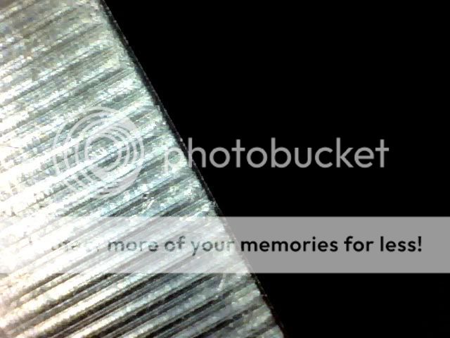

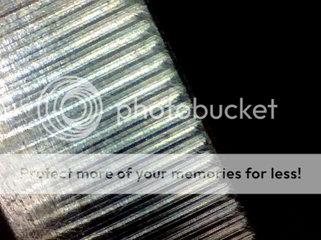

My regular camera is objecting to trying to take phots of shiny stuff at night with a flash ... but my magnify camera thing works ok
This is the mora edge blown up a bit .
The stone touches the actual cutting edge and the shoulder , the factory milling is not touched . Its only like a 1mm hollow grind tho .

We have (as far as I know) never made a hallow ground knife. A knife edge should not bend as easily as you describes. Could you please specify what knife type or model you have and maybe a picture. The branding and steel type is also important information. For us to react to distributors it´s also good if we can learn in what part of the world you are at.

My knife is a Mora Clipper , hi carbon steel blade . I am in Australia , but I bought this from the USA where they are cheap to buy .

I was thinking of flattening the bevels on my grinder , but its flattening out OK just thru ordinary sharpenings . The flat of the blade has had the most work on the stone so far , but you can hardly see that its been touched .. I think that milling the bevel left a hollow grind of sorts and at that part it was just a bit too thin for what I was doing . Its good now tho . Hasnt folded or rolled since , tho it does get a few tiny nicks but I suspect it has to do with cutting thru inclusions in the wood I was dealing with .

From my experience, moras when there are brand new, tend to be very slightly hollow ground.
You hardly notice it by eye, but you can see it from sharpening marks on a flat benchstone.
To be honest that hollow is so slight IMO it virtually doesn't make any difference, and it is completly gone after a few sharpening sessions.
