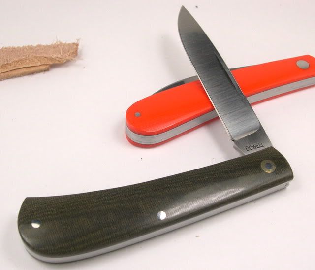

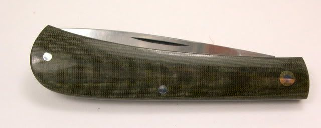

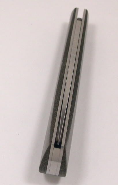

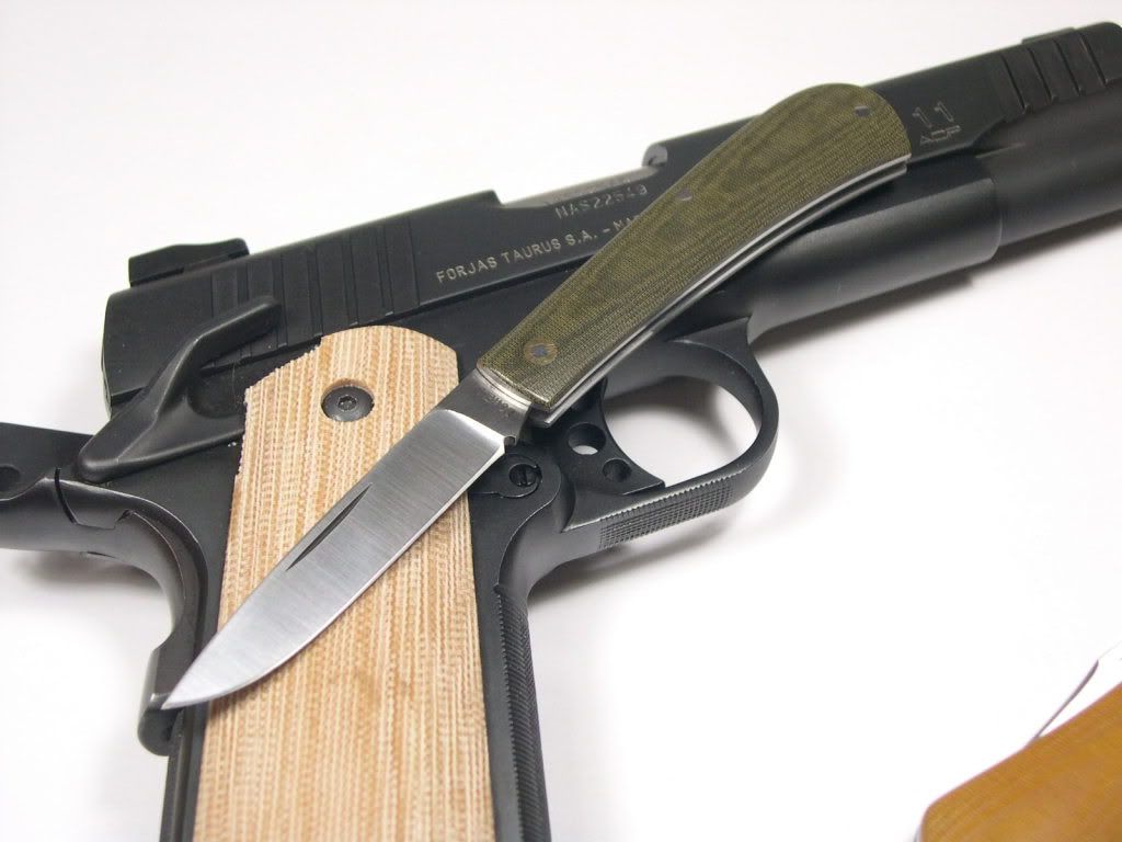

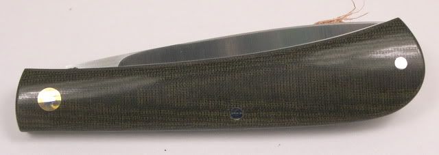

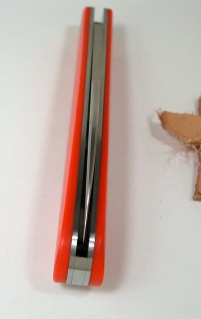

Bret Dowell drop point shadow Trapper with green linen micarta handles.
Bret, did a nice job on this knife. If you look at the pictures. He raised the handles to almost cover the blade tang. Which makes it more pocket friendly. Fit and finish as always excellent. Back spring is maybe .002 low with the blade closed. Otherwise this knife is almost perfect.
Handles green linen micarta.
Steel ATS34.
Blade thickness .080 .
OAL closed 3 3/8
Blade length 2 3/4. Bret gets a lot of blade in his handles.
Hollow ground to .010 behind the edge.
Snap is firm but not hard, just about perfect.
Blade has a half stop.
Stainless liners and pins.
Handles taper from .360 at the pivot to .410 at the butt.

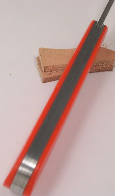

If you hold it up to a light , no light comes through the backspring.
