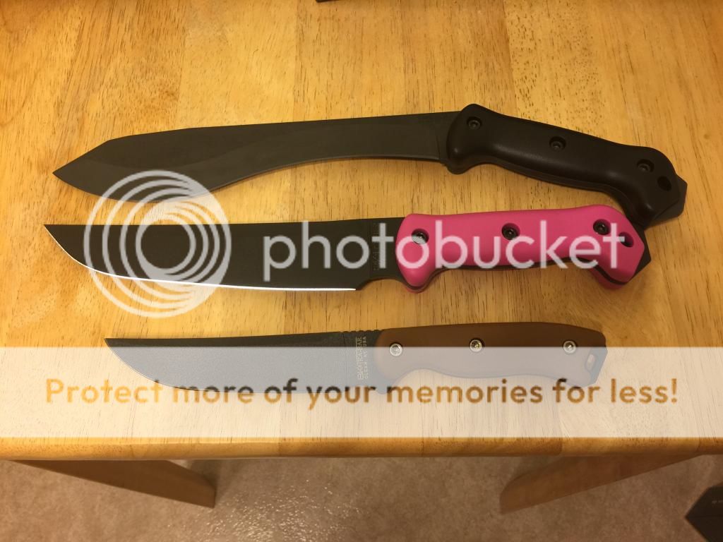

In an honest attempt to NOT thread-jack kendric, here is the Dexy goodness that arrived today. The Stealth has arrived!!!!
The hen really likes her five (it was a Valentine's Day gift). I showed her the scales, and she said "ooh... yeah put those on there."

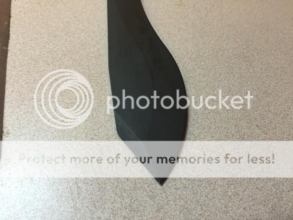

Look at this park-job!!!

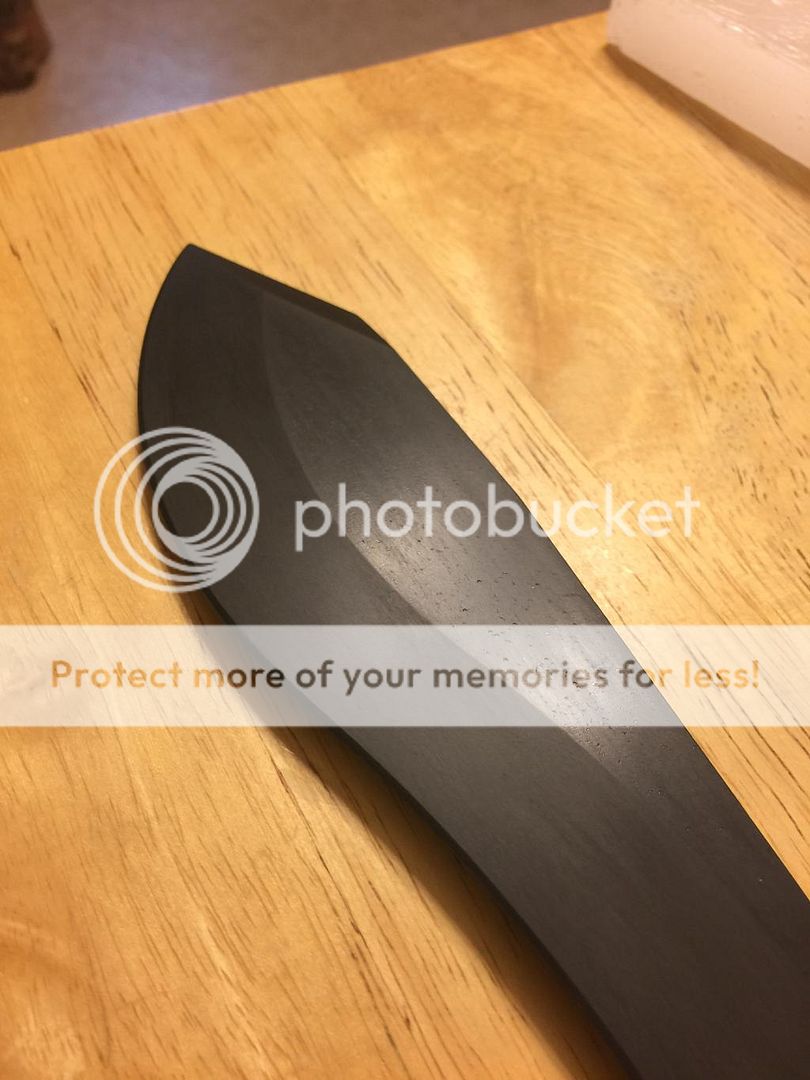

I have paraffin waxed one side, and it came out absolutely amazing. I waxed only one side, because I will be doing a video review of Dex's parking that will include durability testing. I want to know if the wax will help out at all.
If you ask me... I think the wax made the park appear a little darker. Anywho... stay tuned for the video as I'm proud to announce it will be my first of many. I'm starting a YouTube channel that will focus on real world performance. Thanks for checking these blades out.
