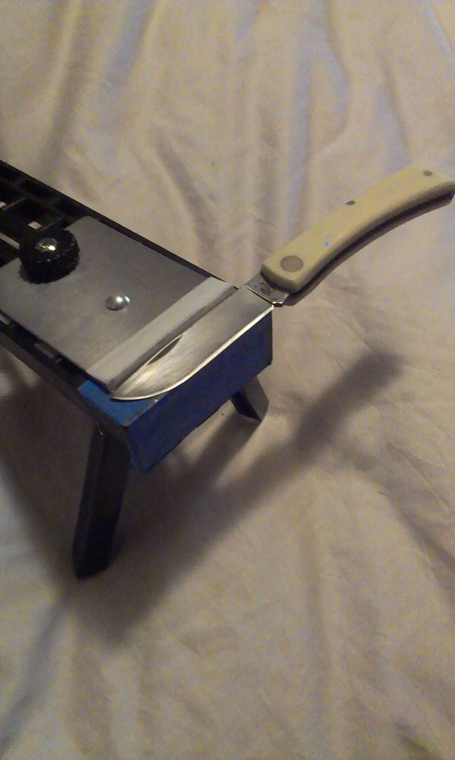

I'll say this though. On my clone, the only problem that I've had on my GEC slipjoint is a bevel that is wider in some areas. This is not the fault of the sharpener though. The actual blade is (was, I re-ground it flat) was not perfectly flat. That caused the wider (or shorter) bevel in some areas. It should get you what you're after though.

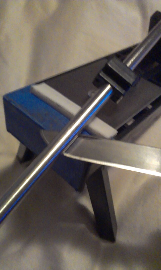

Interesting. I can't figure out what the block is used for. I just go with (or without, depending on my needs) the guide clip if the spine is square and don't have an issue, even with a quickly dropping wharncliffe.
Maybe I can snap some pics.
Sorry for the crap pics, but this is the light is have right now.
Again, not sure what the riser block is needed for?

You move the blade around on the table with this sharpener. In the case of blade tips, pull the blade back so the belly/tip is in the same position as the rest of the edge.

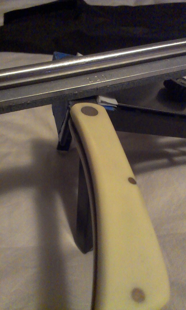

If/when your stone is at an angle that interferes with the guide clip remove it.
The guide (the steel plate on top of the table that moves back and forth) can occasionally be more of a hindrance than a help for me when doing touch ups. In that case (rarely) I've had an easier time just moving it back and going without it all together. It probably would be difficult not using the guide when heavily using a stone/reprofiling, but you have good clearance with the clip removed. In the last pic you can see how the clip can interfere with the stone, but I've never had to do more than remove it.
The sharpener is pretty versatile and flexible. Your technique will make the difference on how you use it. Technique comes with practice. The blocks may be helpful to some in certain situations, but I've never had a situation where I couldn't figure out an simple work-around. It's easy to over think until you use it.

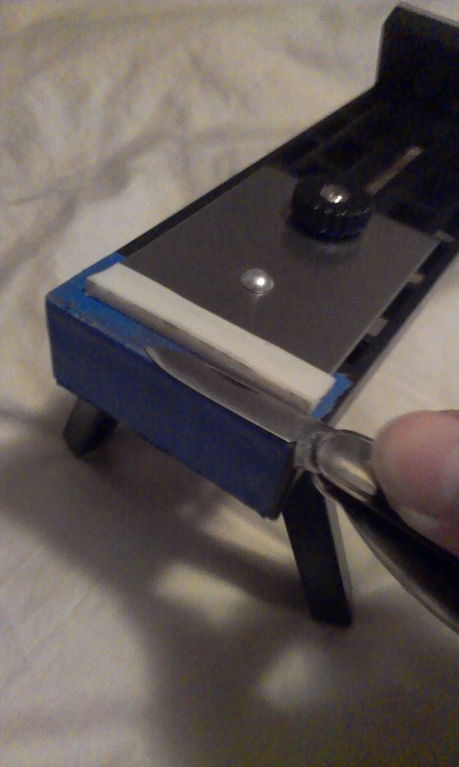

Strigamort, thanks for the info. and the pics. So, with the small pen blade in the second pic, do you pivot the blade on the spine so the tip sticks out and can be reached by the stone or...?
Andrew

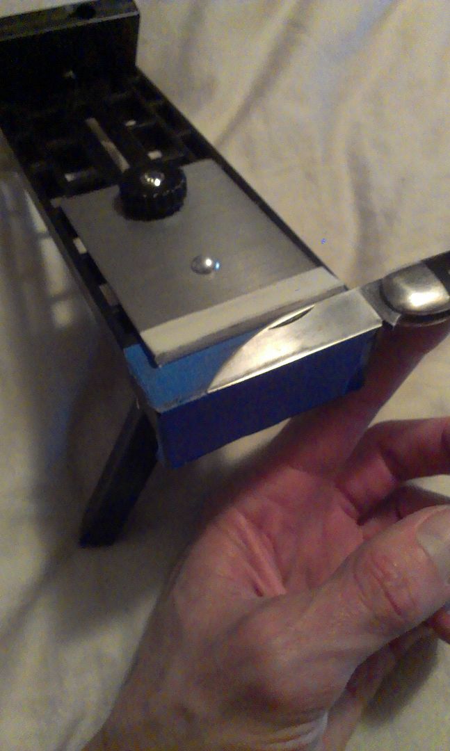

Yeah, that's exactly right. Pulling the blade back so just the tip (heh) is on the table, you don't need to move the guide. The corner of the guide is against the spine. You're kinda holding the blade at a diagonal (flat on the table of course) so that the tip is in the same spot that the straight part of the edge was. I'll take another pic of just that if it'll help.
Honestly, when you go to use the thing, it's very easy to understand and do.
Sorry for the ultra blurry pic.
That's what I mean by diagonal. Didn't feel like I was explaining it very well. :)
The Sodbuster, of course, is an extreme example because of the sharp curve at the front of the blade. Most knives have a lot more belly that arcs more gently. Also, you don't have to move a blade constantly to keep the edge right there. In fact, on my Contego I don't move the knife at all. I imagine something like a Buck 110 may be fine the same way.
Strigamort, thanks for the additional info. That pic explains it very well.
