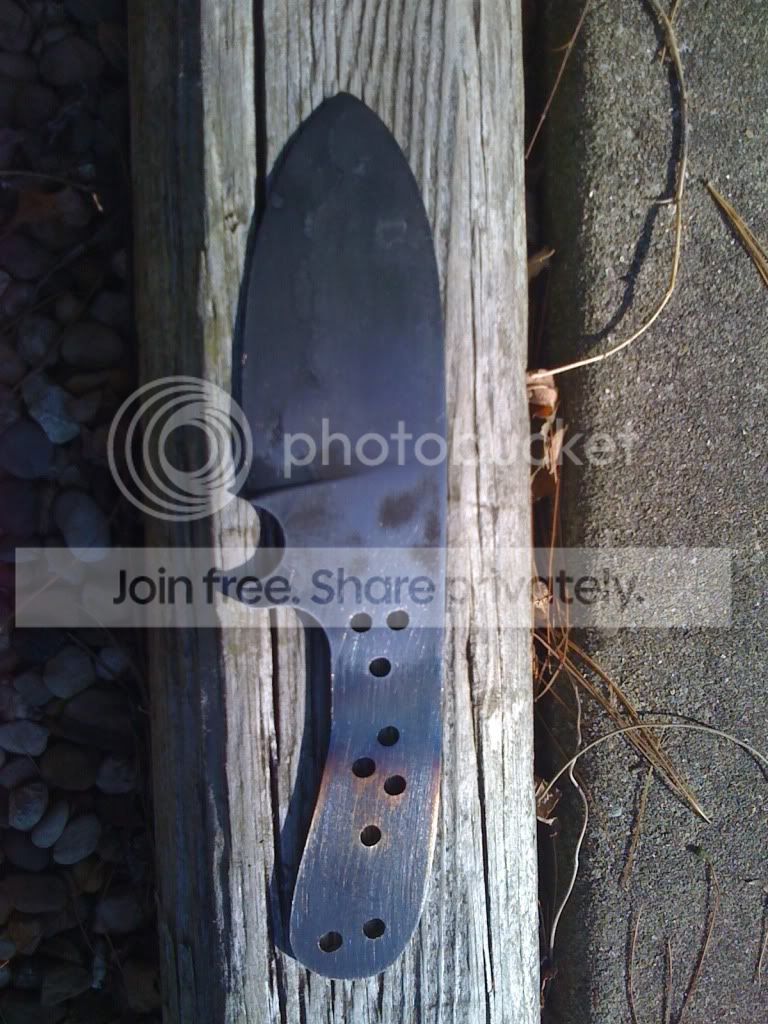

Well, first off it's been almost a year since I found and joined this site. What a great resource of people and talent. So what do you get after being here for almost a year. You go from this, 1st real knife made
To this,

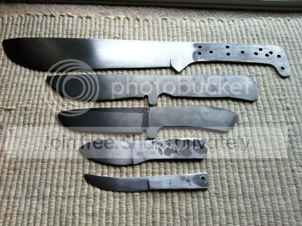

To these, not all of which are done,

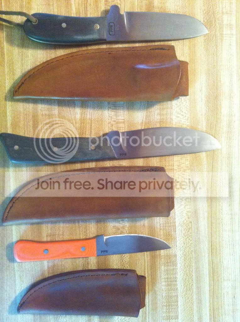

To these,

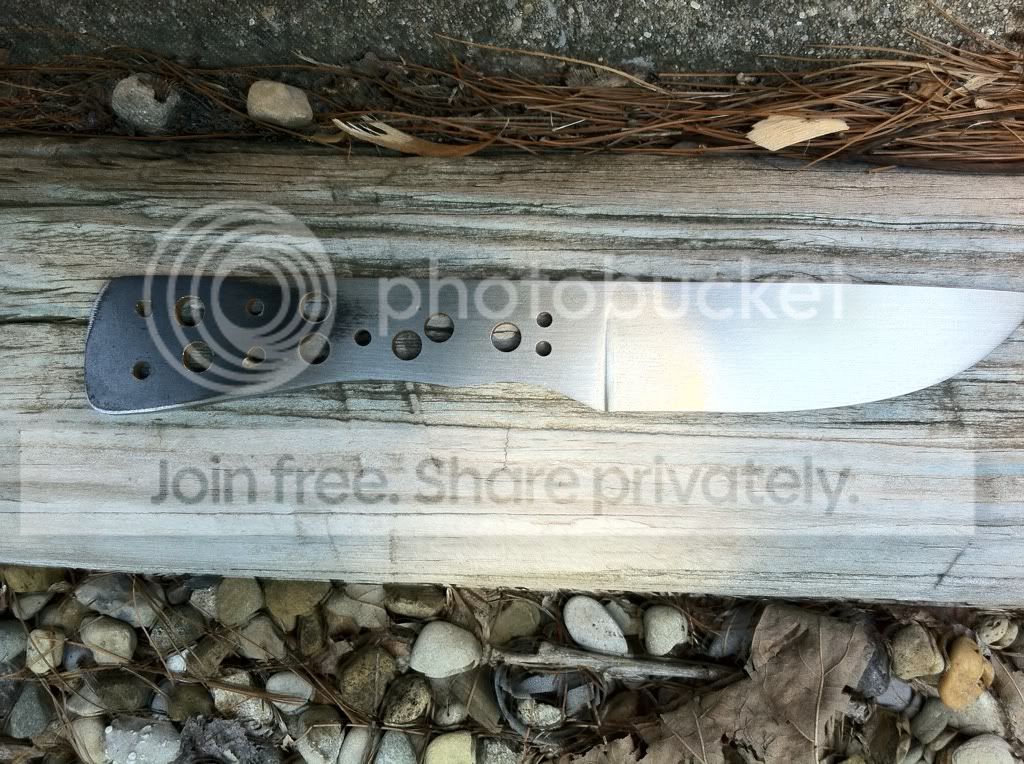

To this,
I think this is my cleanest design yet and certainly my best grinding. I will post when it's finished and I think it will be very nice. Thank you to everyone here for helping me and all the other new/wannabe knife makers.

Excellant work so far :) I expect that your a weekender / spare time maker like myself? May I offer a few suggestions?
1) Use a file guide. for grinding your plunges. These are EASILY made. It will sharpen your plunge lines.
2) Round off the edges of your handles. a square handle like those will cause blisters. I round and blend all mine with a Bastard File, whether it's bone, wood, or micarta a file takes it off fast enough to be easy, but slow enough to catch and fix a mistake before it gets too far out of hand.
3) more of an opinion thing, but when I grind a "companion" (Fixed Blade EDC) type knife, I start with 1-1/4" wide stock (thickness is up to you) but put a slightly forward blade design on it. kinda like the blade pictured below. IMHO it gives it better aesthetics and ergonomics in most of the uses for a blade.
You have made a lot of progress. Your talent is showing through.
