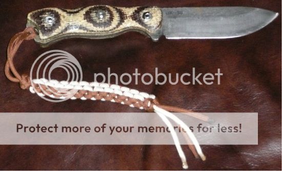

Other than smoothing the pivot washers on my Para2, this is my first knife mod. All you Beckerheads gave me the confidence to try it. I know it's not perfect, but I'm extremely happy with the outcome.
Most of the work was done with the either the BK-16, a soldering iron, WSKTS, or Dremel. Of course, a number of hand tools were involved, as well.
.060 Kydex shaped into liners, to fit my XL/XXL hands.
Ground down the finger area to enable the strap to snap.

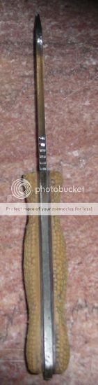

Stippled the handles for traction. Then sanded with MX180 since the dimples were a little deep and sharp.
Replaced black hardware with stainless - cut down oversize screws.
Sheath trimmed down to match the handiness of the knife.
I saw someone recommend "grape" liners, but I couldn't bring myself to do it. Besides, I prefer strawberry preserves - but nothing goes better with "peanut butter" than "chocolate"!
Funniest part was, I had just completed the stippling when my wife came to see what I was up to. I told her I was fixing the handles. She grabbed the one I had just completed, and said "good - it needs to be fixed!" I let her handle my remaining unmolested black one - she liked it better. Ah well, I don't expect her to understand.
Like I said, I'm happy - but if you see anything amiss and have recommendations, I'm open to constructive criticism.
Feel free to show yours, and share how you did it.

what did you use to do that stippling?
I flattened the tip on my Radio Shack soldering iron with the Worksharp.
Once heated up, I held the tip at each spot for 1 - 1.5 seconds, (it sounded just a little crunchy as the plastic melted away) then moved to an adjacent one.
I thought I would get bored or frustrated, but I did a little the night before, to make sure I could - then just did it while watching Mentalist, and finished before the show was over.

I went a little beyond...
Layed up my own "mycarta", and ground down to fit my hand.
May not be the prettiest, but they feel great, and now they're flush with the tang.
Mod # 2 & 3 - and probably the end for now. Unless I'm not happy after using it for a while.
