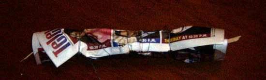

Awhile ago I posted about firestarters with hemp+wax, recently I used wax+shavings. I made a pile of shavings from a piece of birch layed them on a piece of newsprint and put about a tablespoon of candle wax in a line. Then rolled up the paper, tied it, then ran a line of wax the center :
http://i7.photobucket.com/albums/y269/CliffStamp/fire starters/tube_starter.jpg
This catches as easy as paper, but the wax keeps it going for a long time, paper just flares, the wax melts and ignites the wood which also wicks the wax. You need it on a slant for maximum flame, the higher the angle the more aggressive the flame.

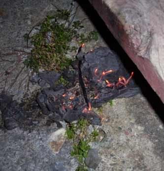

If you just burn it by itself it burns for 5-10 minutes depending on the angle and leaves a pile of red hot shavings :
http://i7.photobucket.com/albums/y269/CliffStamp/fire starters/tube_starter_end.jpg
You don't need to make them this large of course (this was about a foot long), you could also used charred cloth at one end to serve as a spark igniter. This also allows the use of wood which doesn't tend to burn well as the hot wax and wicking action allows it to burn well.
