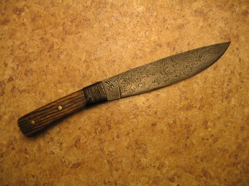

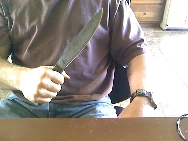

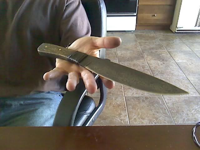

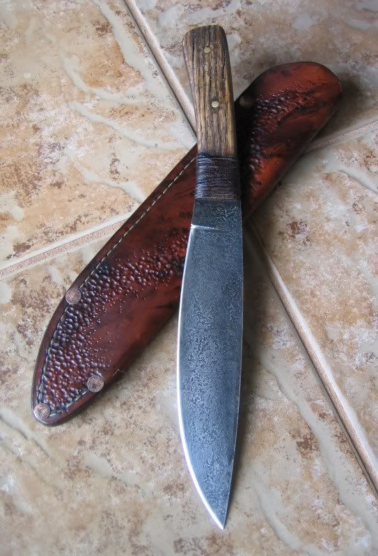

I just shipped this off to a customer today. Its my Bushmoro model.
Material – 5160, handforged
Thickness – 3/16" at spine, flat/convex bevel
Blade length – 7” cutting edge, 7 1/2" incl. ricasso.
Blade width - 1 1/2" at widest, 1 1/4 at ricasso.
OA length - 12 1/2", balance point at center of ricasso.
Handle slabs - Oak, 5" long, brass pins, rawhide wrap(epoxy sealed), finished with tung oil.
Finish - Rough forge finish, vinegar etched.

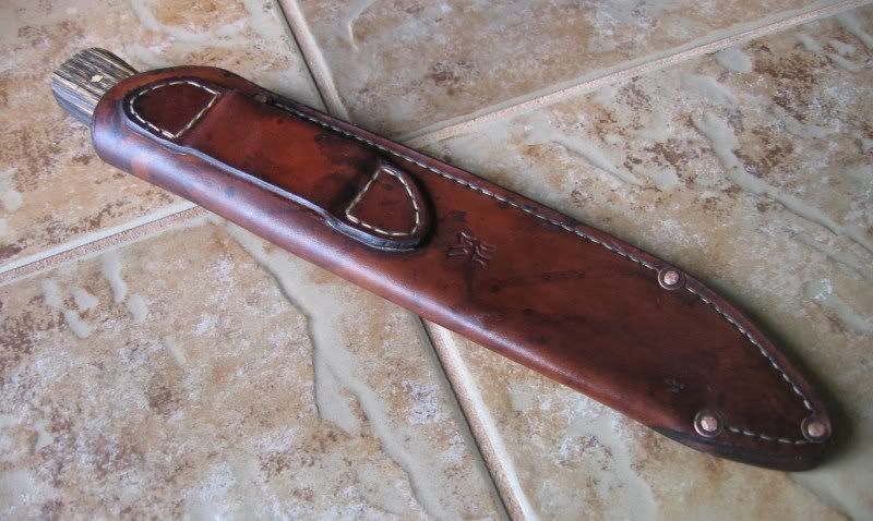

Sheath - 10oz vegetable tan, hand stitched and riveted.
Rick
I really like that. You brought it all together nicely. The rawhide wrap looks great.
looks great. how much does something like that cost? it looks SHARP.
Wow! It is unbelievably sweet bro!
Rick your work has a wonderful rustic, yet refined quality and your style just keeps getting more refined with each new addition. And, your blades are the sharpest things to come down the pike since the Samurai sword.
Great stuff buddy!!
