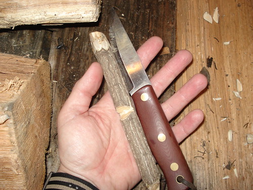

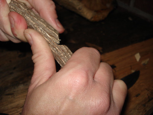

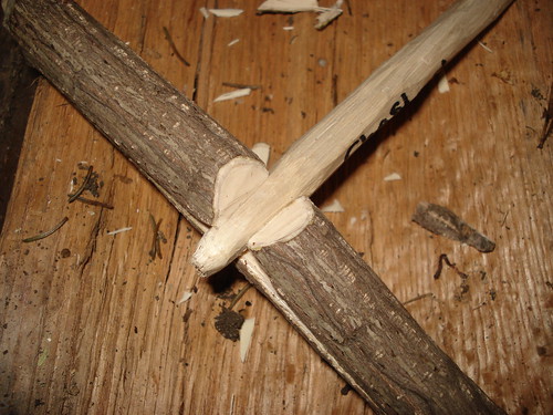

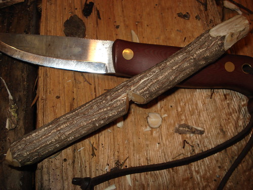

After my family super shelter post some have asked about the Mors cloths pin so I put this together.

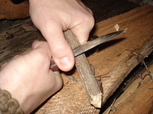

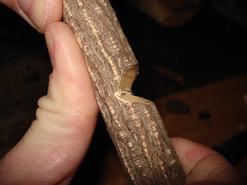

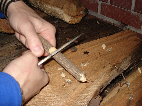

Use a green stick about 6-8"long and about 1"thick. Cut a V notch about half way through the stick.
more..

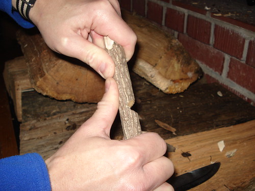

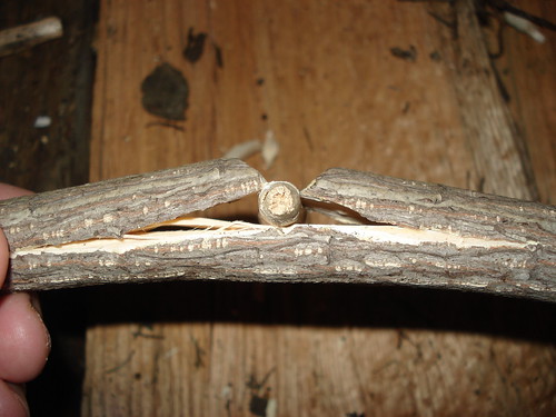

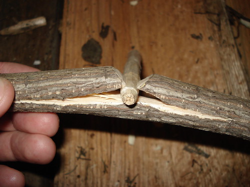

Now place your thumb past the V notch and bend the stick..see pics..do this on each side right and left.
After the stick is split on each side clamp it.
more..
