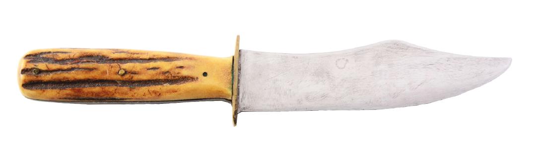

Haines's Marbles pattern. It wasn't just a fantasy made up for Marbles, he had a custom version made up before the Marbles one, and used it for a couple of years, before getting Marbles interested in it. The major difference is that I think the custom version had a wood handle.
Haines was also big on axes, particularly the cruiser sized double bit.
The Haine's knife always looked totally impractical as a hunter to me. But I know how it goes, if you goring to approach a company about making your knife design it needs to look completely different than whats already on the market. That leads to all sorts of weird designs. As for Morseths, I don't think they ever found much favor with "subsistence backwoodsmen." Good knives but they were a luxury items for most hunters.

Hadn't thought of it that way, but it's true. I looked through a few articles I had saved on him, and in the August 1920 issue of Outdoor Life, he mentions leaving the Haines Marble's at camp, and just carrying a folding knife (no mention of style) now, he also mentions that he'd redesign it if he had the chance. Wide, curved, and thin were his main design points. The article makes it sound like the Marble's version hadn't been taken afield for years.

The Haine's knife always looked totally impractical as a hunter to me. . . .
Examine Half Face Blades' Crow Scout. Delete the guard from Haines' knife and there it is — albeit with less blade radiusing or curvature. I own one from the original non-California location. It is entirely practical as general camp, field butchering, and kitchen knife. Since relocating to California, HFB prices have adjusted from very high to "You must be joking."

While I read Haines' article on his knife, he still didn't convince me it was a very practical hunting knife. Between the wide handguard and the strange upswept hook point blade, it looks like something that would be a real pain to use on game. Someplace I read the the Marble's Woodcraft replaced it. In my opinion, the Woodcraft makes a much better game knife.
