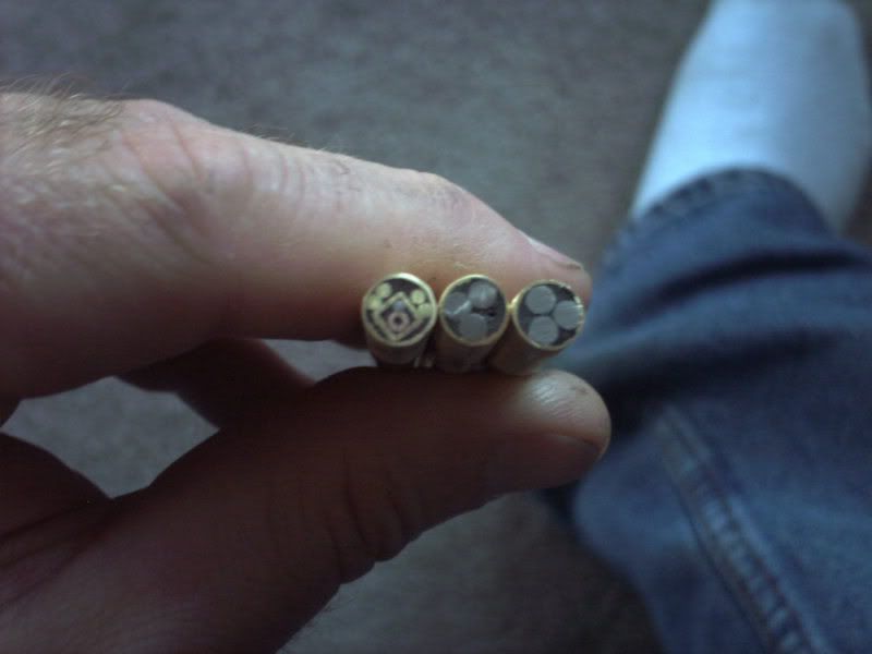

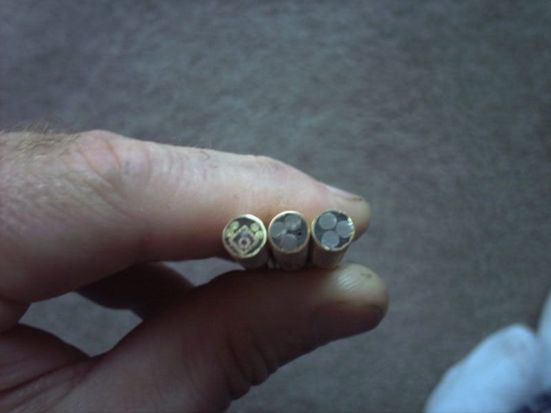

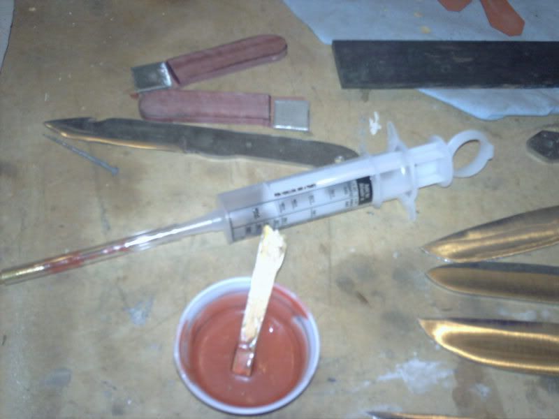

So I decided to try some pins.... the first couple, brass and steel, black epoxy, turned out ok but you must remember when making these without a vacuum, remember which end of the straw you are putting in your mouth :yuck: ... Of course I had to try it again and this time I found a large syringe with a length of tubing. So $40 worth of brass, steel and copper later... Kind of fun, I suspect I will be making a bunch of these.
I think Im starting to get the hang of it.. This was yesterday.
Look good for the first round, filling getting them filled is the pain in the neck,if there solid all the way through with epoxy your the man!

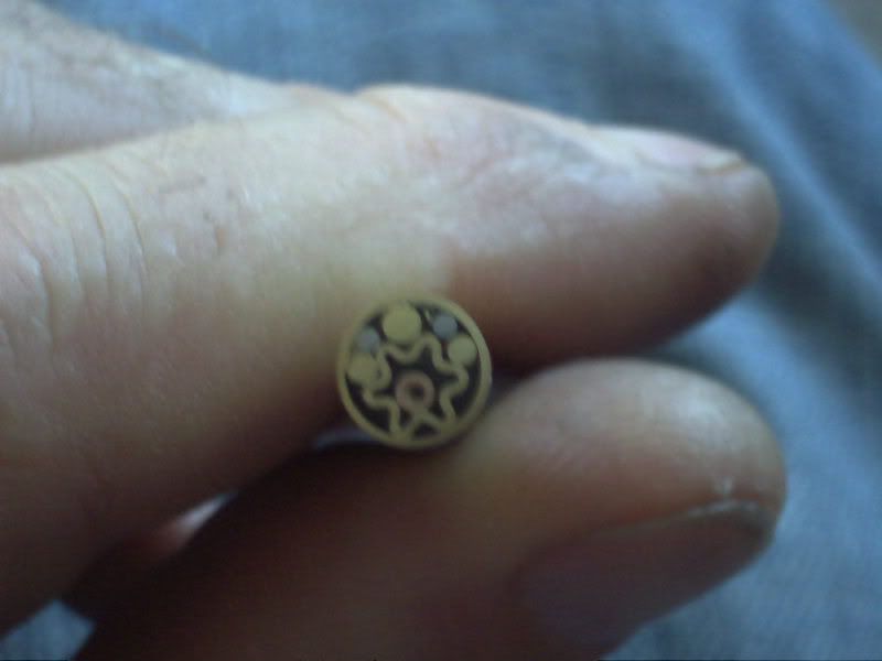

I did buy a wide array of brass, copper and steel rod in various sizes.. hehe. I also coloured the star and the square, they were supposed to be red but didnt seem to turn out. I hope the colour will come out as they get more polished. I do have glow paste as well but I need to experiment with that before I make some pins with it. Of course, I was going to buy some (a lot) resin and colours from resinobsession.com but restrained myself and stayed with the fiberglass resin and some hobby paint I already own.

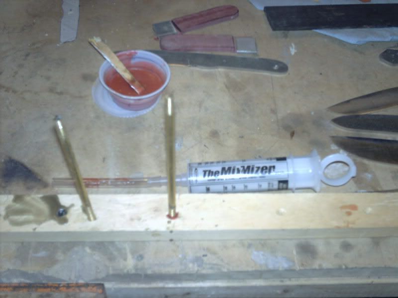

Just thought I would post a pic or two of my sophisticated system for mosaic pins :-D. I use fiberglass resin and acrylic hobby paints and then just place the pin in a hole drilled in some wood. I should coat the wood with something though, to make it easier to take the pins out.
I really like that latest one! it reminds me of the face of the bolt (not sure if I am using the correct term) of an AR-15 for some reason.
