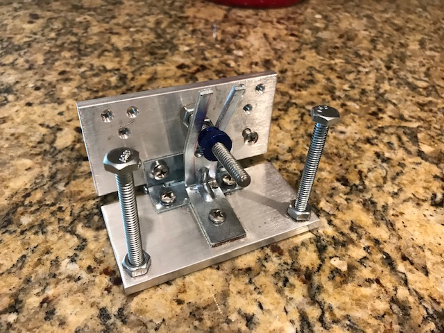

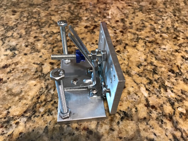

Here are pics of the Jig. after 5 mins or so grinding screws loosen and If I don't constantly re-identify the angel and reset the screws; I will get bad/uneven/wavy angles.
Use lock nuts on both sides of your angle adjustment. It'll require a wrench to make any adjustments, but will be very secure.
i was thinking a stiff spring between the blue knurled nut and the forked part should keep them from loosening.
Why do you have two adjustments? Vertical Bolts against work rest and the knurled knob?
The bracket the knurled knob is against isn't square so the knob and nut are only contacting at the corners. Any flex in that bracket will cause the bracket to straighten out and possible spread apart and the knob or nut will loose tension and possible loosen off. A piece on angle with the two adjustment bolts would be much more secure.
I think that vertical bolts serve as handles to hold jig not for adjust .No reason to have two type of adjustment at once
You can try this ............cut where is red line , drill new hole where is that red circle , straighten that part as it is on second picture .No reason to be bend like that if you work with 2-5 degrees angle , that way that two nuts will stay tightened .... As it is nuts have almost not contact with that part and you can t tighten them properly.
