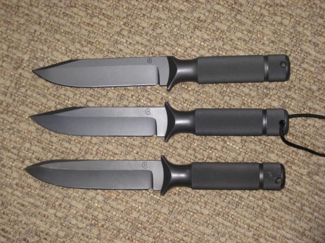

If I had to have only one it would be one of the 5.5" knives. I have the Mark VI and Shadow IV and hope to pick up a Mountaineer II soon. The Shadow IV is a very clean looking, tough knife but I think I'd give the Mark VI a slight edge due to the clip point's advantage in fine cutting tasks.
I only recently became aware that the blade on the Mountaineer II has a higher grind than that of the Mark VI. So for fine cutting tasks, the Mountaineer II would be a real winner. As far as pure blade strength, however, the Shadow IV is the toughest, followed by the Mark VI.
In the 7" length, my favorite is the Project I (spear point). In this longer length, the extra weight of the spear point feels good in the hand and provides some chopping advantage. A 7" knife is a bit long for fine cutting tasks anyway so the clip point is a little less useful in this length, in my opinion. In addition, the 7" knives have thicker blade stock than the 5.5" knives. This makes them very tough and fun to use but less practical for fine cutting tasks.

Here is a pic of what "JohnM" was talking about with the higher grinds. Top is the Mountaineer II, Middle is the MKVI, Bottom is the Shadow IV. JohnM's advise is right on the money.
