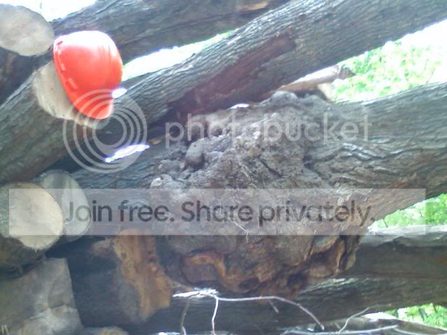

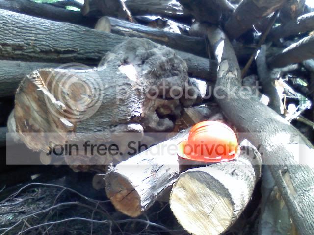

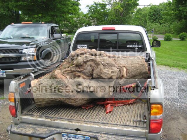

I've only ever finished 3 knives, and then I got a new job which takes all my time away. I travel New York state as a tower rigger (cell towers). We are building a new tower in Oswego County, and cleared a lot of ash and maple for the the tower location, and look what I'm bringing home the end of the week! I've been looking hard for burls when ever we clear a location. The county actuallycut these trees and the property owner was beginning to cut them up and split them for fire wood when I showed up on the site this morning! He looked at me like I was a little crazy when I asked him if he was actually cutting it up, and told me if I wanted it he would cut it off and let me have it. Needless to say it's strapped down on a trailer now and it'll be in my shop friday night.
I've looked and looked for burls, never thought I would find one this big. So the question now is... what do I do with it. always thought I might find one just big enought o get a couple small blocks out of it for handle scales, never considered finding one this big and where to take it, how to cut it up, treat (stabalize what I want from it, etc.). Any of you makers do your own burl handle materials from start to finish? Any tips on where to start, or what you would do with it if it was yours? I don't have much time to work at home anymore, but this has me motivated to get at it again. Thanks for any advice or direction. Mark.
I am no expert but there are a few on the forum and maybe they will chime in! My advice is to seal the cut ends immediately with anchor seal or latex paint. It will need to dry for a long period of time before it is useful! As too how long I think it may be in the year+ range.
Then it will need to be cut and stabalized before it is useful as handle material!
I would say cut close to the burl cluster on both sides and see if the burl actually grew into the tree is is just on the outside of it. This will help determine where you cut it at. +1 on Dixie's post. You will need to seal it and let it dry for a minimum of a year. Anchorseal will seal the moisture in causing it to dry slower but more stable. When you decide to cut it up, might be best tu cut the log from top to bottom as opposed to trying to cut the burls off the trunk. This way you dont end up with as much unusable end cuts. Check your local sawmills, they will probably be willing to cut it up for you for not too much money. When you block it out...plan to spend a few days at the table saw and bandsaw lol.

Wow... crazy looking burl! :) Most of our burls here in the Pacific NW just look like a big round-ish bulge. That one sure is funky! :D
I'd be excited to see what's inside of that!!! :D Nice score! :)

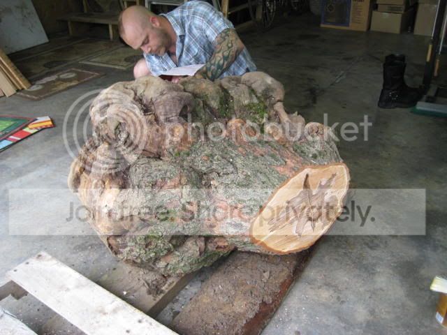

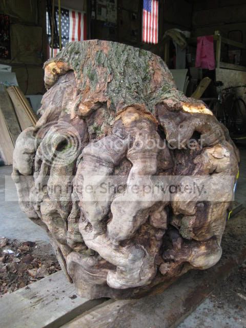

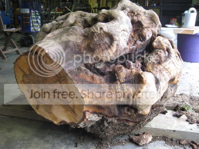

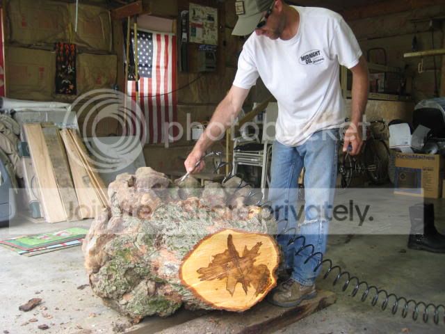

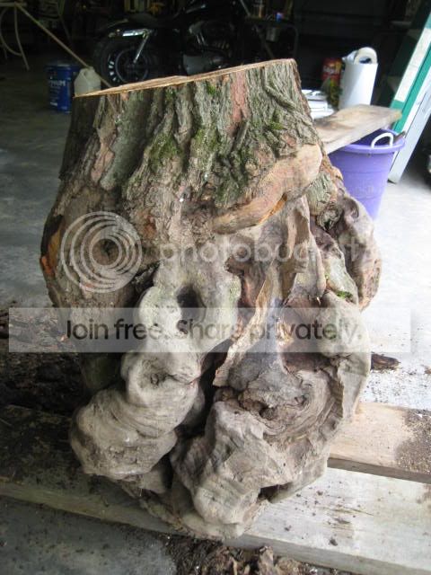

I got the burl home, could not believe how heavy it is, had to strap it and pick it with a back hoe bucket. Sealled the cut sides of it, cleaned most of the dirt and loose bark off that I could, then stood it up and we stared at it the rest of the night. I don't know what I'm really going to do with it, would love to get some handle scale blocks out of it some day, who knows for now. Anyways, here are the pics. Enjoy...
Man,Thats a real cool chunk of wood!No telling what kind of weird figure is lurking in there.Keep collecting that stuff.
