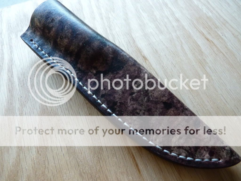

So I'd like my sheath to have a mottled finish. I have Fiebings spirit based black and green. I'd like it mostly black, but with hints of green poking through. How do I get this finish? Green first, then black on top? Black first? Green first with black only on parts?... Sanding?
Also, can (or should I?) dilute the dye with anything? I've read, in a walk through, that you can dilute oil based dye with alcohol. I also read that adding a tablespoon of olive oil to the 4oz bottle is good, but I'm not sure if that's for the oil, or the spirit, based dye.

I would dye it green first, then with a dauber that has very little black dye, just do small areas till you get the finish you want. No need to dilute the dye, use full strength.

I've been experimenting with wetting the leather in random shapes before dyeing and although I haven't perfected it yet I think it has potential .
Try using a fine artists paintbrush to make lines and shapes on the dry leather with just plain old water, then quickly dye the leather while those areas are still wet .
You certainly get an effect with lighter coloured dyes .
Not sure if that will be what your after , but if you have time experiment with some scraps .

I was watching a Springfield Leather video last night on dyeing and they showed a method where they dyed a piece of leather a light(ish) brown followed by some blending at the edges with a darker brown, finally, they finished by rubbing a very light coat of the darker dye on the entire piece. Looked nice and simple but I'm not sure if that would work in the case of green and black.
I'm not sure if mottled is the right descriptor. I guess I'm having trouble with the description, but I mean for it to be mostly black with areas (like splotches) poking through. I've seen the effect done to where it's best seen in daylight otherwise one might only see the darker color. Usually I see this with browns, or less frequently, with red and black or brown as the dominating color.

Unfortunately a step by step "how to" with pictures and more than a few steps doesn't happen overnight. Mottling, in some cases involves many layers of color.
Is my picture what your looking for? I dont want to waste my time going in the wrong direction. :p
