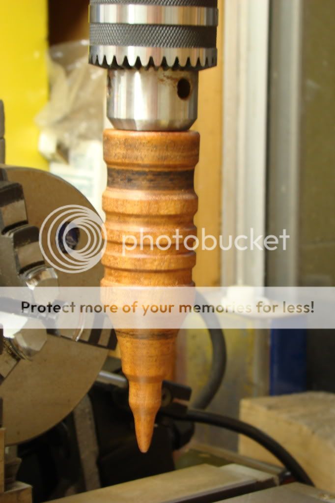

I"m using this one made of Osage now and I like it much better.
I like the finished look it produces better....just my preference.
Did you make that????:D
I am a bit picky about edges, so I still do some work by hand prior to using the machine, but it still saves me time over my old routine.
My buddy worked the lathe, I supervised and furnished the wood and the beer.:D

I have been making a few of the burnishers for awhile, a friend bought one at a leather show made out of plastic and wanted one of a hard wood so we made a couple on my wood lathe, pretty simple to make once you have the block of wood, I have made a few out of ebony and they work great. Bill
One small question about the width of the grooves of the burnisher. Are they suppose to be a little wider than the leather? Or are we trying to round the edges a little at the same time as we burnish?

My opinion is to make the grooves in the wood 1/16" wider than the intended thickness of leather to be worked in it.....works for me.

Mine turns at 3600rpm on a buffer. I tried it on the lathe at around 1100 rpm and it doesn't work as good but still faster than by hand so you can try it with the drill press.

The burnishers that I make are ment to be used in a mill or drill press, and you can speed them up r slow them down, they work best (for me) at about 1100 to 1300 RPM's. I make them with all size crown's to fit the thickness of you leather I even make a point for burnishing drain holes and around the back of the belt loop if you wanted to. I will try to include a couple of pictures if I can. Thanks for looking, Bill.
WOW...at 3600 rpm I bet there is smoke!! I have mine attached to a 1/2hp motor turning at 1725....I'm sure a 1/4 hp would work just as well......
Made one out of cocobolo yesterday to see if there is a difference.........not much, but prettier.:confused:
