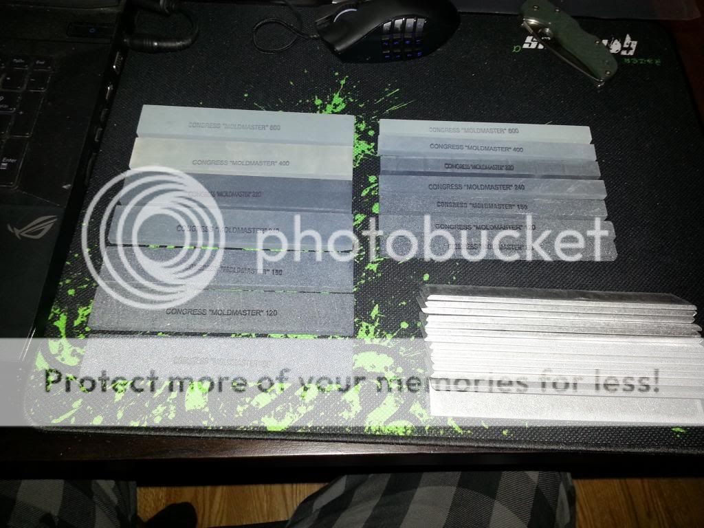

Just received a couple stacks of congress moldmasters and a pile of EP blanks. I read that Ben Dale uses 3M 77 to adhere the stones to the blanks. Should I stick with this? Does anyone have another recommendation? Is there any particular prep work that I should do prior to mounting the stones other than making sure the stones are flat? Thanks.

The 3M77 worked like a charm and was easy. Spray all the alum. blanks, spray the back of the stones, let 'em sit for a minute or two and stick them together. (Just make sure you have them lined up properly before sticking them together... once they contact there's no adjusting.) No need to flatten anything, I never did, unless maybe something is really off. I lined them all up and did them all at once. The ones that are left are still stuck. :)
