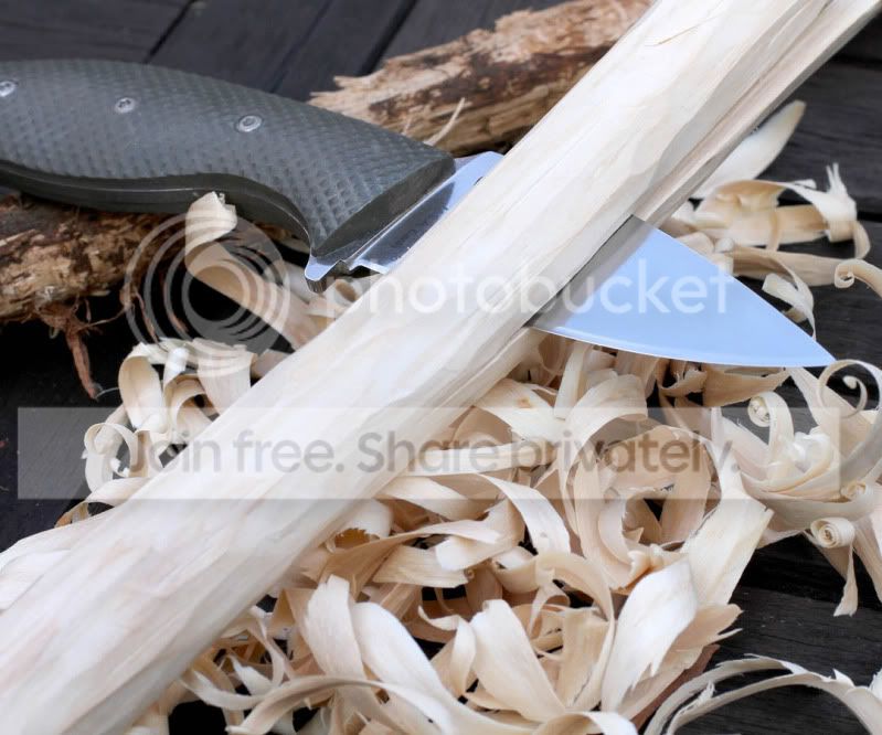

Here are some pics of my Cruwear Mule experience so far. (NOT scientific- this is purely seat-of-the-pants stuff.)

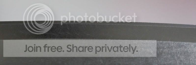

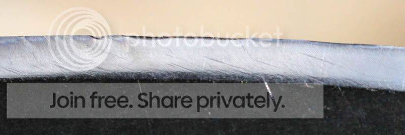

Macro of the edge at approx 20deg inclusive:

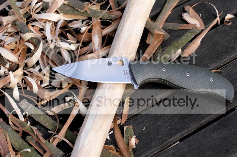

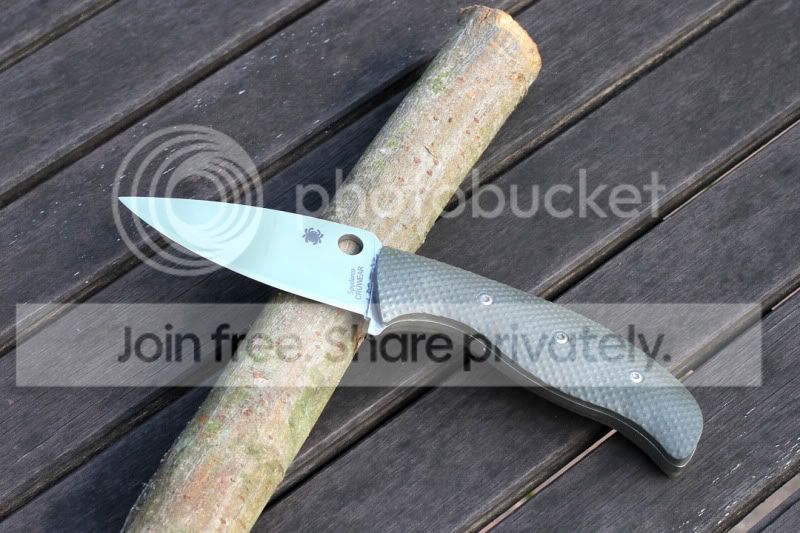

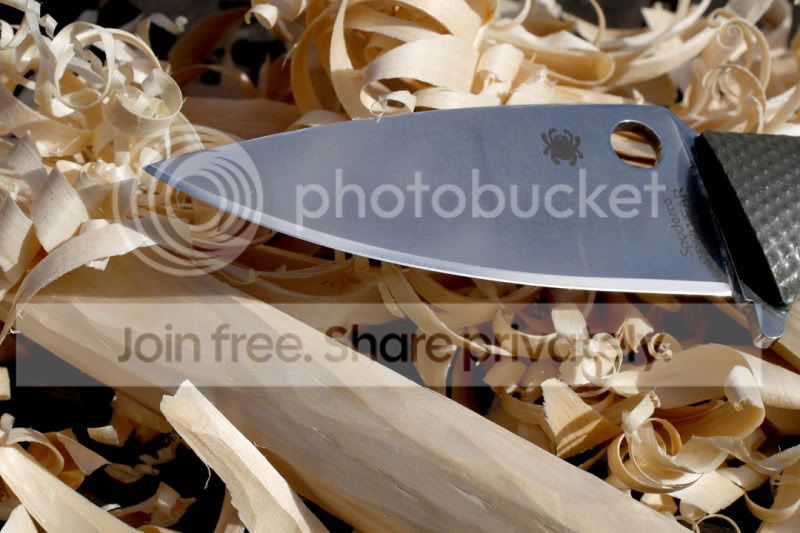

The knife and a piece of wood to play with:
Stripped off the bark:

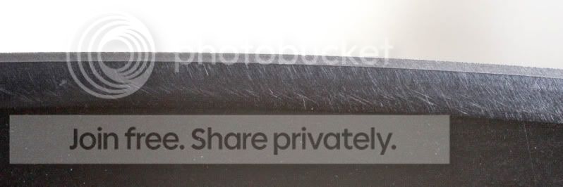

Edge:
I think 20deg inclusive is a pretty severe test of a blade steel but I usually try a new mule at this angle and then add a 30 deg microbevel. If needed this becomes a 40deg microbevel.

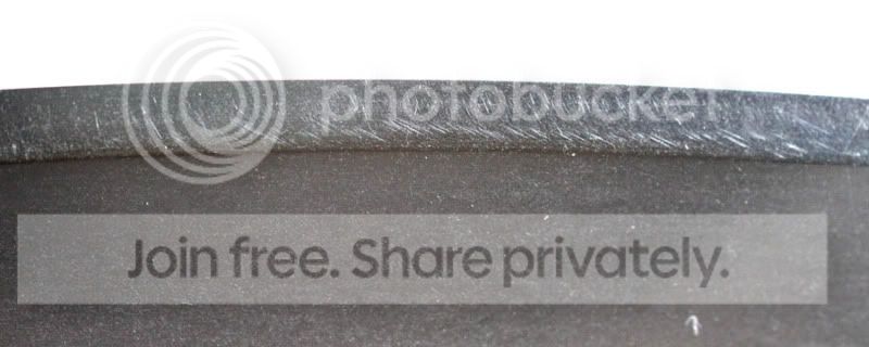

So I put a 40 deg microbevel on:
Edge Macro:
Ready for retesting:

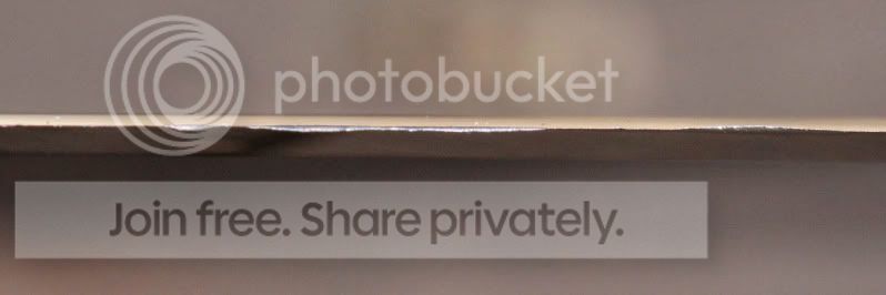

Edge afterwards:
Without a macro lens there is no visible edge damage. Slight damage visible on the macro pic.
I'm not sure what to make of this blade yet. This was a very brief test comparing a 20deg inclusive edge with a 40deg microbevel/20deg backbevel. As such, all it compares is edge stability, since I did not do enough cutting to test edge-holding. Given how soft the steel seems to be with the file comparison (with M390 and Superblue Mules, see other thread) I am a bit concerned about the heat treat.

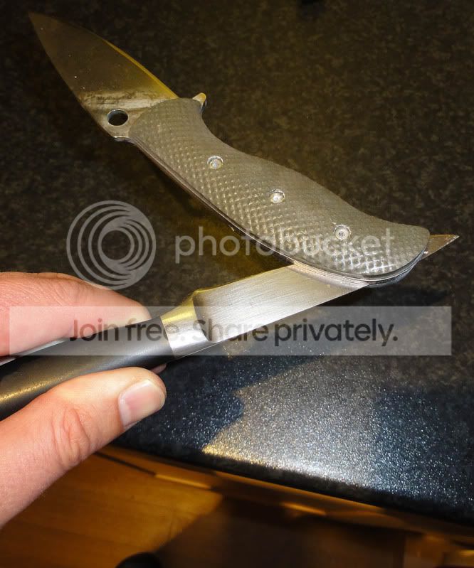

As in my post above, I had noticed the MT12 Cruwear Mule seemed a little soft. I did the "file test" comparing it to the Aogami Superblue and M390 mules and there was a marked difference:
M390 Left; Cruwear Middle; Aogami Superblue Right.
I took a video of the test and it is uploading (slowly...)

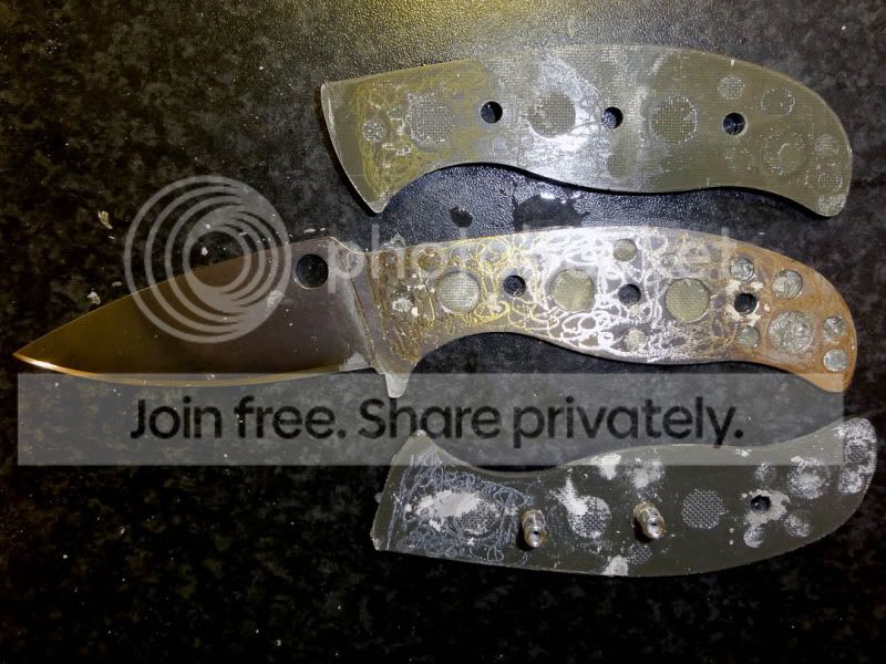

I'll be interested to see what Sal finds as mine seems v soft. Wish I hadn't done the scales now. I'll post some usage pics for comparison, too. Anyone got access to a calibrated Rockwell machine?
I still think the Mule program is a credit to Spyderco, BTW. I hope this constitutes useful feedback and doesn't put Sal off releasing more interesting steels for us to try.
Here's a vid of the file test (I'm no videographer, as you will see.)
[video=youtube;uR-i3qcLtVU]http://www.youtube.com/watch?v=uR-i3qcLtVU[/video]
There was a palpable and audible difference in the way the file bit the metal (see the still pic for scratches left.)

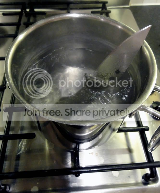

My final experiences with this release of the MT12 Cruwear Mule:
Cooking:

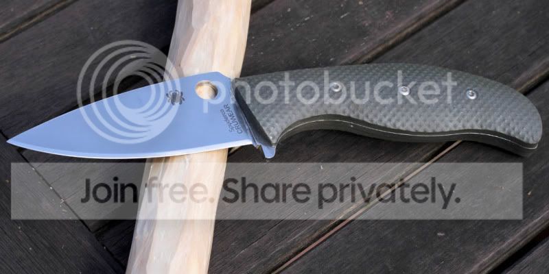

I hope this Mule has enjoyed its brief holiday in England. Tomorrow it goes home with its brother. Hopefully they'll be back for a longer stay soon...
Sal Glesser has posted on these at Spyderco Forums - the HT was defective and they are recalling those that have been sold. :( A stand-up company and management. :thumbup: ^3 Edit - whoops, here too.
I've been using mine at work, and and I'm quite pleased with it. Sharpening takes far more effort than the first one, which is a good thing. Edge retention is excellent, with no unexpected chipping or rolling. Looks like they got it right this time.
