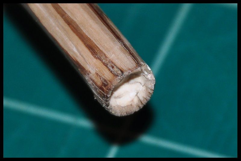

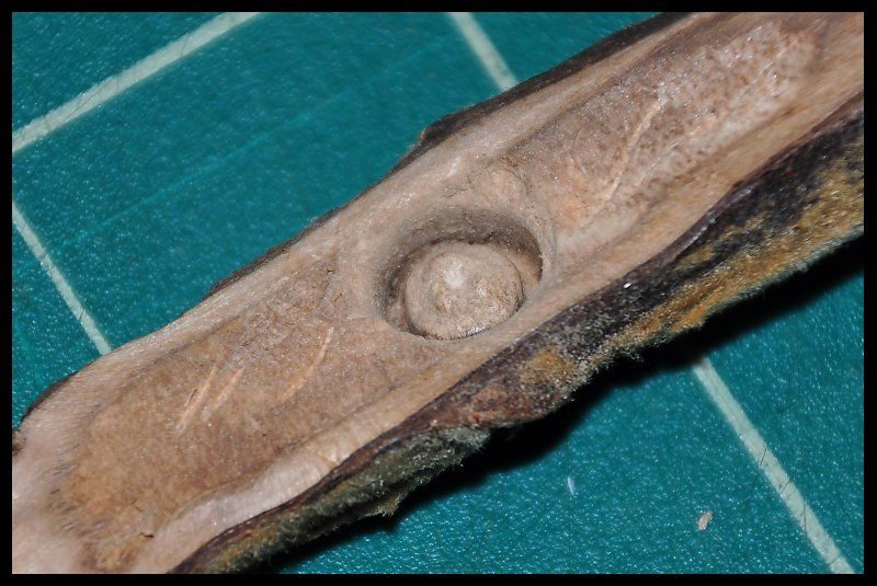

i've gotten several coals with bow-drill so i figured it's time to move on to hand drill...what's going on here? this is an all mullein setup that i harvested a year ago that was already dead-standing and been sitting in the garage since then so it's super dry. the drill's bark is eating up the base so i stripped it off but both sides are still getting cupped...seems like the drill's center is way too soft and the shell is way too hard?
am i setting it up the wrong way or using the wrong parts of the stem? i first make the drill pointy like a pencil and make a pilot hole in the base board with the tip of my knife like how i would do a bow-drill setup.

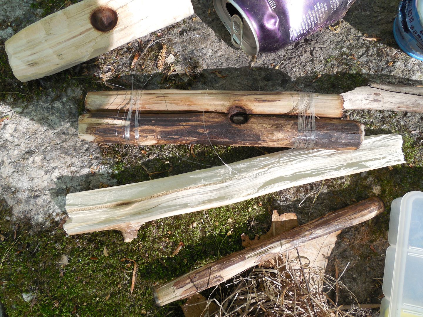

Maybe tie the two mullein sticks together. Here I got a coal with mullein on mullein but it also works great with a wooden spindle for bowdrill. I have no clue if this will work for hand drill however.
I am thinking that it is the woody outer that makes the friction and fire, so maybe try a harder hearth for the mullin spindle.
Hey JV3. Personally, I don't like Mullein, although a lot of others do. I prefer Teasel (Dipsacus sylvestris) and Jerusalem Artichoke ( Helianthus tuberosus). When you use a weedy plant like those above, it always has a softer centre and you will get the situation you describe above. BTW, I normally use a hand drill with a wood base - my favourite - Basswood (Tilia americana)
Once again, I can't tell you much about Mullein because I've only used it a few times, but it seems that the time of year you collect Teasel determines the thickness of the "hard outside wall" relative to the diameter - the thicker, the better. The longer it has been standing dead, the thinner the wall seems.
Codger is correct about the "woody outer" being the working part.
When the "hill" in the centre of the divot gets too big, causing increased resistance to the drill, use the tip of a knife to pop it out. You can also remove some of the hearth in the centre of the divot before you start drilling.

And one other thing: "JV3 said: i first make the drill pointy like a pencil and make a pilot hole in the base board with the tip of my knife like how i would do a bow-drill setup." Instead of making a small divot in the hearth like you do for bow drill, carve a dish shape in the hearth in which to place the drill.

nice! i've seen mistwalker do the same thing. i'll try that one too for when the hearth isn't wide enough.
