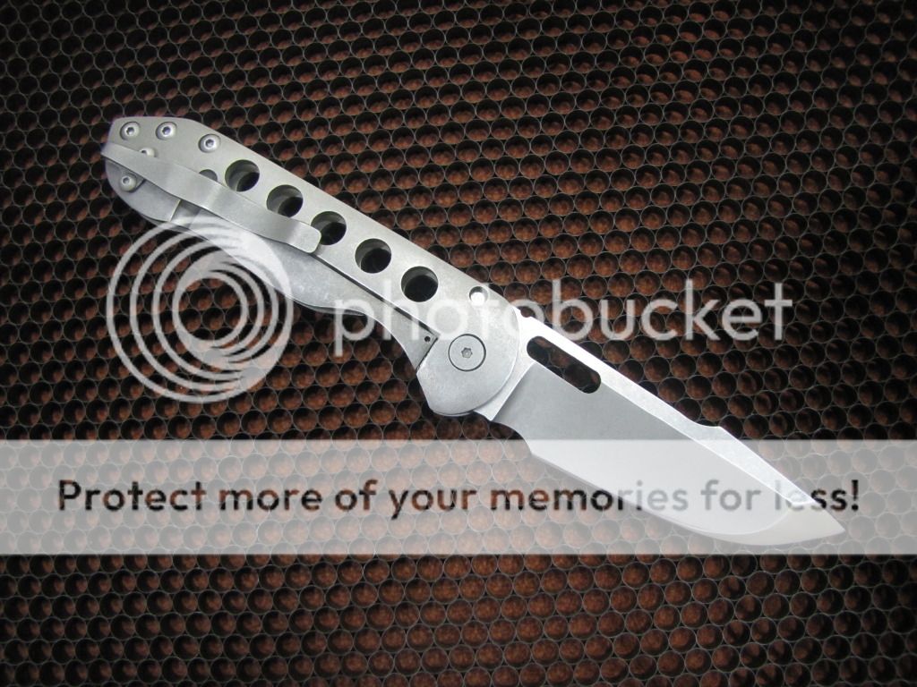

Daniel Fairly and Jeremy Horton are a couple of knifemakers here that do compound grinds:
