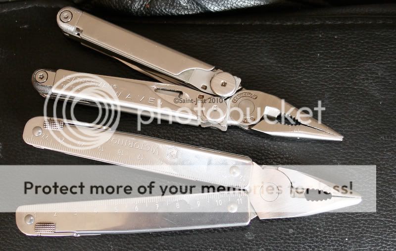

Victorinox SwissTool has a sturdy plier head and the handles don´t bite into the hand since all other tools are on the "right" side.
Here the head is compared to the Wave.

These multi-tools are not properly matched size for size. A better comparison, I believe, would be between the Swisstool and Super Tool 300. In that matchup, the pliers are roughly equivalent, with Leatherman providing superior wire cutting ability. I find the ST 300 needle nose more versatile than the blunt Vic's, but that's a personal choice. Also, like the Swisstool, no palm pinch.

O.k. here is the comparison with ST 300, I still think the Swiss has the upper hand for strength which was TS concern. Also it is easier to apply a high force and less risk of pinching the hand than on the sharper edges of the ST 300 .
Also the machined head of victorinox is inherently a much stronger fabrication method than powder casting. LM are more prone to brake which a Quick search will give many testimonies of.
